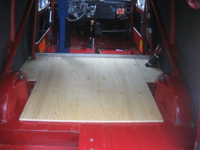

Here is Diddy with the empty Van:

PostPosted: Wed Jul 04, 2012 9:45 pm
Caravans can have Webasto diesel heaters aswell, lovely puff of smoke when they start up :lol: .
What are the two rear tubs for :?: storage...?

PostPosted: Thu Jul 05, 2012 12:31 am
Posts: 460
Yes, the diesel is for the heater (as the plan is still to cross Russia to Europe...when is not yet known). The tank was where the 2nd seat will soon be installed thus the relocate....same for fuel/petrol pump that has been relocated to the crossmember under the scuttle.
Current task is to coat the plywood sheeting used to fabricate a folding floor to expand the sleeping area before "management" arrives. Will get Varathane on starting today as weather has turned dry and warm.
"Wells" in floor - large one inside rear subframe and small one at leftside rear - are for storage. With fuel tank replaced by larger extended tank up front and filled behind the B pillar, the exhaust is routed down the center to transverse mounted muffler to the right of the small "well" and exiting on the rear rightside.
With "new" standard linered block coming from UK and power unit must also come out for rebuild.
