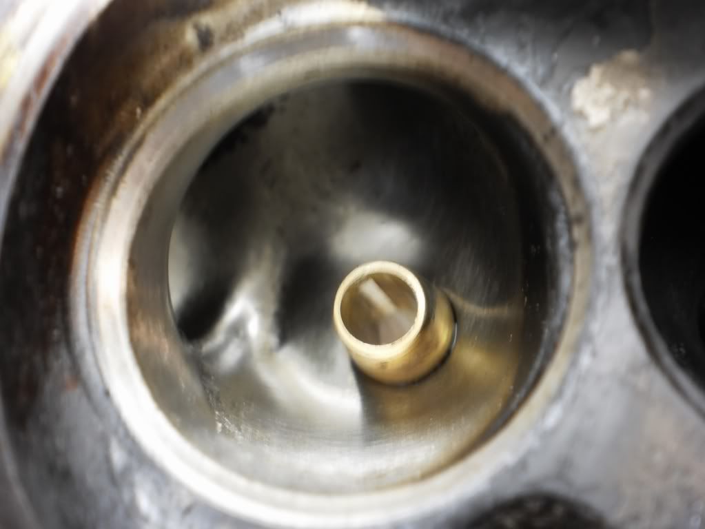

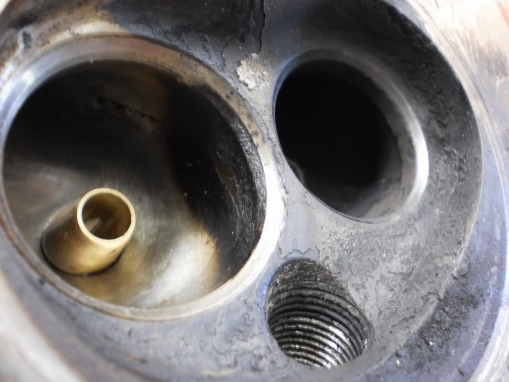

First I want to thank the Mokesta and GR for their pictures.
I've placed them one above the other and as you can see there is a very different approach to valve seating.
On the first picture you can see how the closed inlet would interfere with the expelling of the exhaust gasses. As GR explained and can be seen in the second picture, the flat valve does not interfere with the flow of exhaust gasses across the roof of the chamber.
However in the flow bench of my mind, the intake in the first picture would flow earlier and with less restriction except for the proud exhaust valve, which in this case would give disturbance to the flow as this is the primary direction of the inflow........but then again, both valves are momentary open so it might not be a concern at all.
Somehow it would seem a better idea to bury the exhaust valve so it was flush with the roof and again in my flowbench I cannot see how this would have an impact on performance because of the pressures that the exhaust is pushed/drawn out.
On the other hand combustion would be cleaner in the second pic because I imagine bits of fuel would be hiding in the crevices of the proud valves.
Anyway, I'm just throwing this out to get opinions and explanations.

well,, for starters , i find it hard to believe that (if it were for a race car) that GR would leave the sharp edges around his valves,,, i`m expecting that he has just meant that pic to show his seats & how proud the valves sit off the chamber roof,,, but i also expect that he would normally give the chamber/roof a decent grind/polish to at least remover the sharp burrs/edges so they don`t become super red/white hot spots,,, i also suspect he would de-shroud & shape his chambers too
so hence i don`t see his pic being a final of what his optimum chamber looks like, of this i have no doubt (unless the customer was really scabby & didn`t want to pay so much,,, & even then i`d suspect that if that was the case that GR would say go away :-)
so it`s a bit unfair to compare OK???
so,,, in actual fact, i`d be betting that GR would show some sort of lift in the final roof height & with those sharp edges removed , the "proudness of the valves may not seem so different to Marks.
but i do think (in my opinion) that marks are sitting QUITE proud, probably a little more proud than i would have them, but if he`s got a good, thin, seat , with a decent leading angle before it, then cool...
Mine (generally) are about in-between both pics.

yeah the exhaust seat insert is visible in the pic & they`re generally all like yours now days & are set-up with quite a solid "interference" fit, something like 5 or 6 thou from memory
& you can see the "lead-in" angle cut into GRs head (maybe 20deg? --> the angle-cut just around the outside of the valve heads) but can hardly see any lead-in on Marks head

The head i used is a throw away i just cut the seats on it to show people, so i did not blend the chambers in or lay the chambers back
Graham

I'm getting a better picture now. I see that Graham uses a very narrow valve seat in comparison to standard. By fading the seat back into the port and smoothing it out into the chamber he gets the best of both... recessed valve for better exhaust flow and still get a nice response on lift off.
