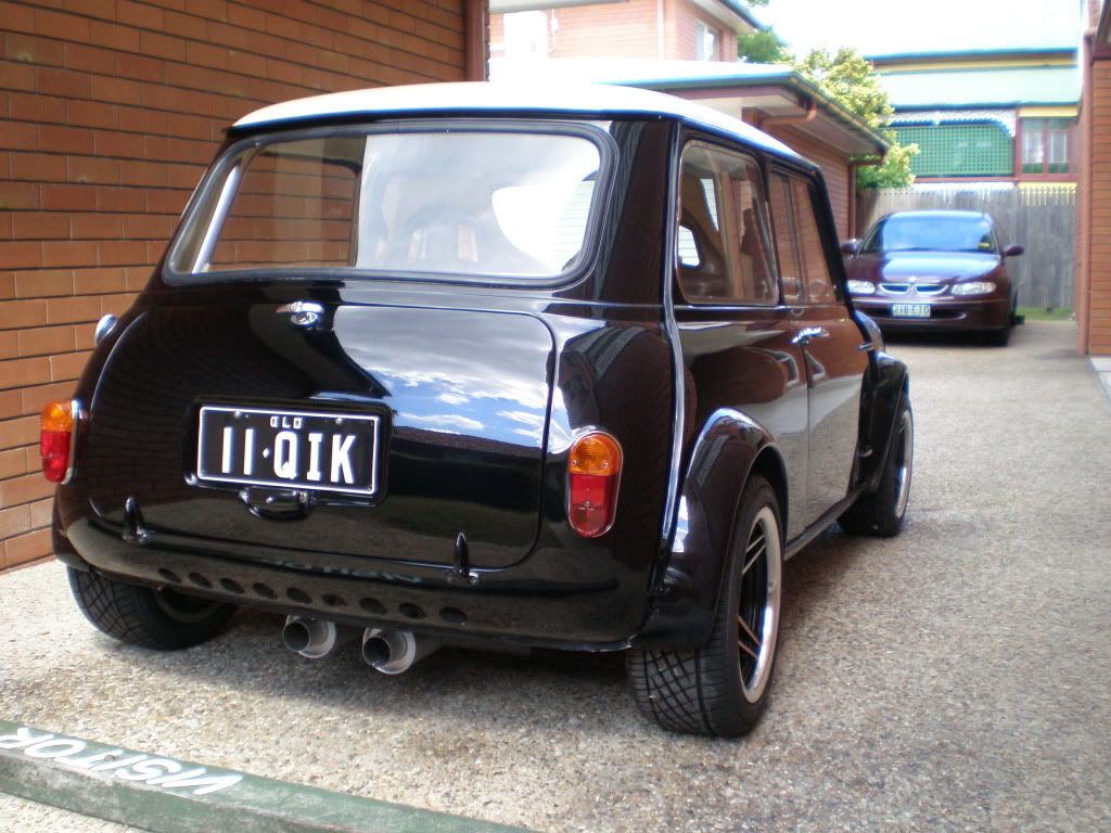

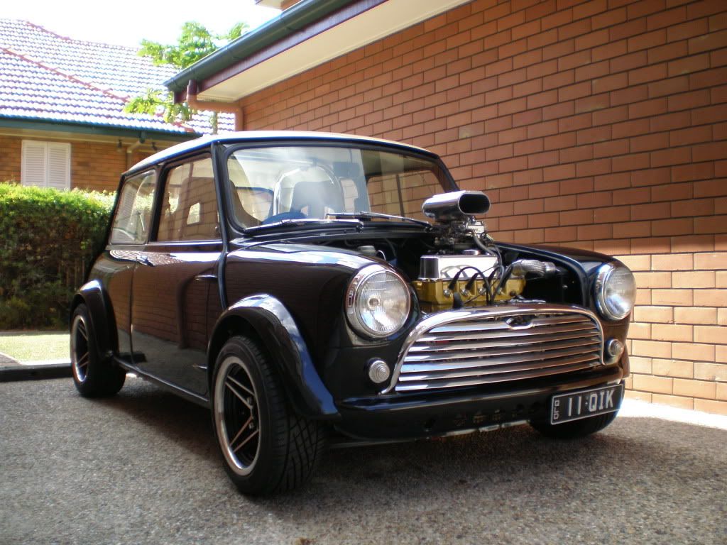

The front sportpack arches have a recess for the side indicator. You will need to fill these with fibreglass. Also the general fit is really crap as they use a rubber spacer between the body and flare. If you put some plastic like Contact or similar onto the body then fit your flare and then mould the flare to the body shape with fibreglass. Remove the flare and sand it back, remove the plastic from your body and you will have a perfect fit.
Also the rear flares are a crap fit around the bottom near the bar. I guess rover thought the bumper would hide that.
