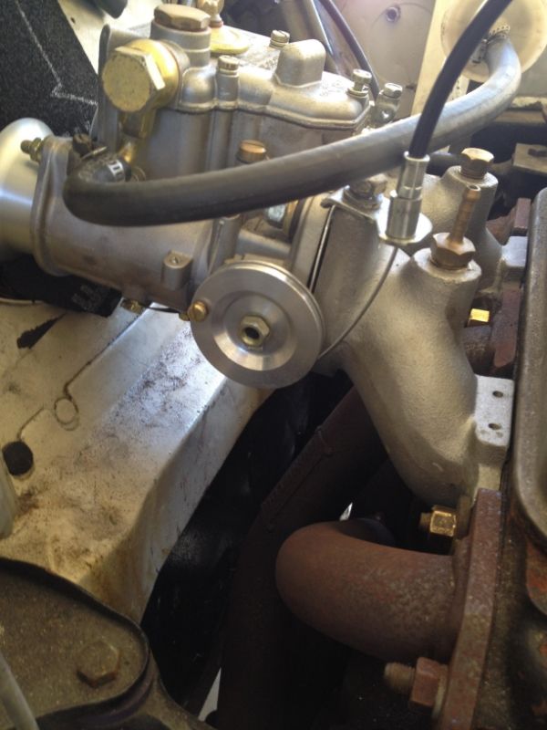

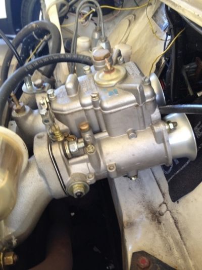

I am almost finished installing my weber but have run into a problem with the acclelerator cable. It does not seem to return after pushing the pedal in. Without the cable it seems to return quite nicely. Here is a photo of the set up.
And the other side of the carb. The trumpets are 26mm if anyone is interested.
Do I need some sort of additional spring return or have I installed the part the throttle goes into incorrectly?

I got told u need a additional spring on it as the one in the webber is not strong enough
 Post subject: Re: weber 45dcoe help
PostPosted: Fri Apr 18, 2014 3:53 pm
Yes you need another spring.
PostPosted: Fri Apr 18, 2014 4:20 pm
Posts: 544
Also make sure that the spindle that the two butterfly's sit on it not too loose. This will give a rubbish return as well.
PostPosted: Fri Apr 18, 2014 5:52 pm
Posts: 806
Location: Woody Point 4019
Thanks everyone for the replies. I figured out the cable guide was putting it at a funny angle. I ended up changing the cable linkage to one that sits on top with two return springs.

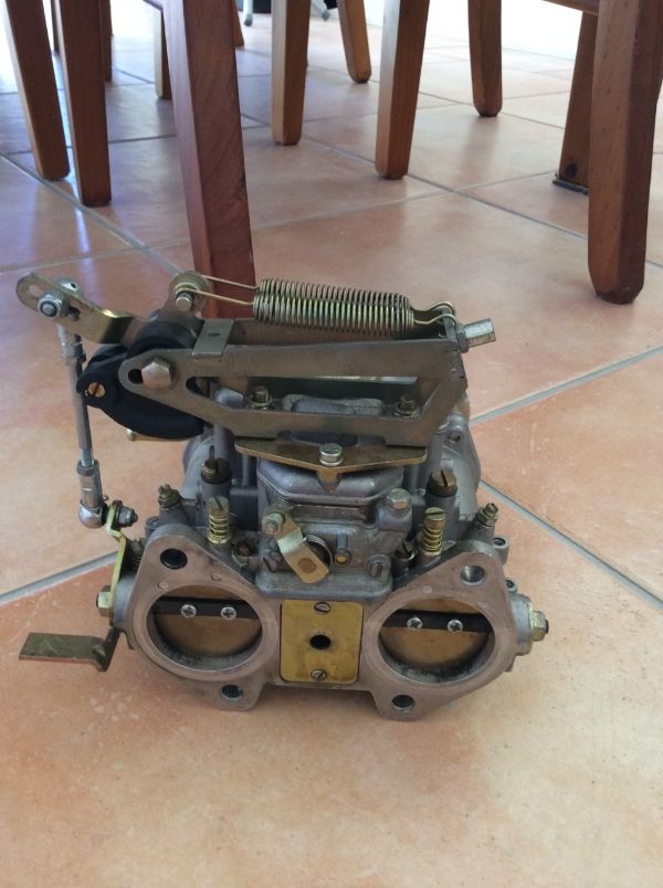

Here you go.
I have the accelerator cable coming around the front. There is a bit of a tight bend but the cable seems to move ok. With the two springs the effort required to push the pedal is pretty substantial so I might take one off and see if it suits me better.
On the very top picture there is a brass fitting that looks like as hose gets attached. Is it the hose from the clutch cover?
PostPosted: Fri Apr 18, 2014 8:02 pm
Posts: 5123
Location: The Internet
Wow that's some setup you have there. Should fix your return problem real good.
The brass fitting there would go to a brake booster through a non return valve or through a PCV Valve to the crankcase ventilation. Or blank it off. Depends on what systems you have attached.
