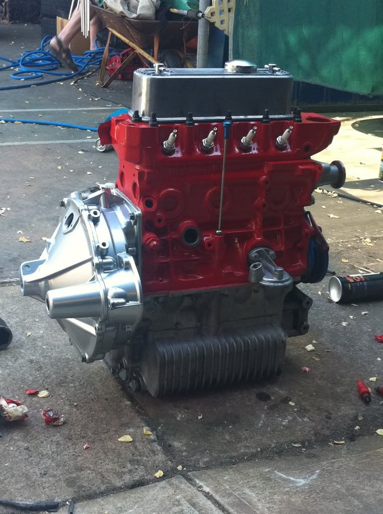

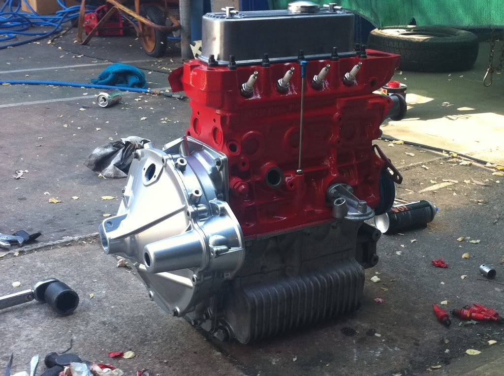

yes you can Powdercoat the transfer case and clutch housing..

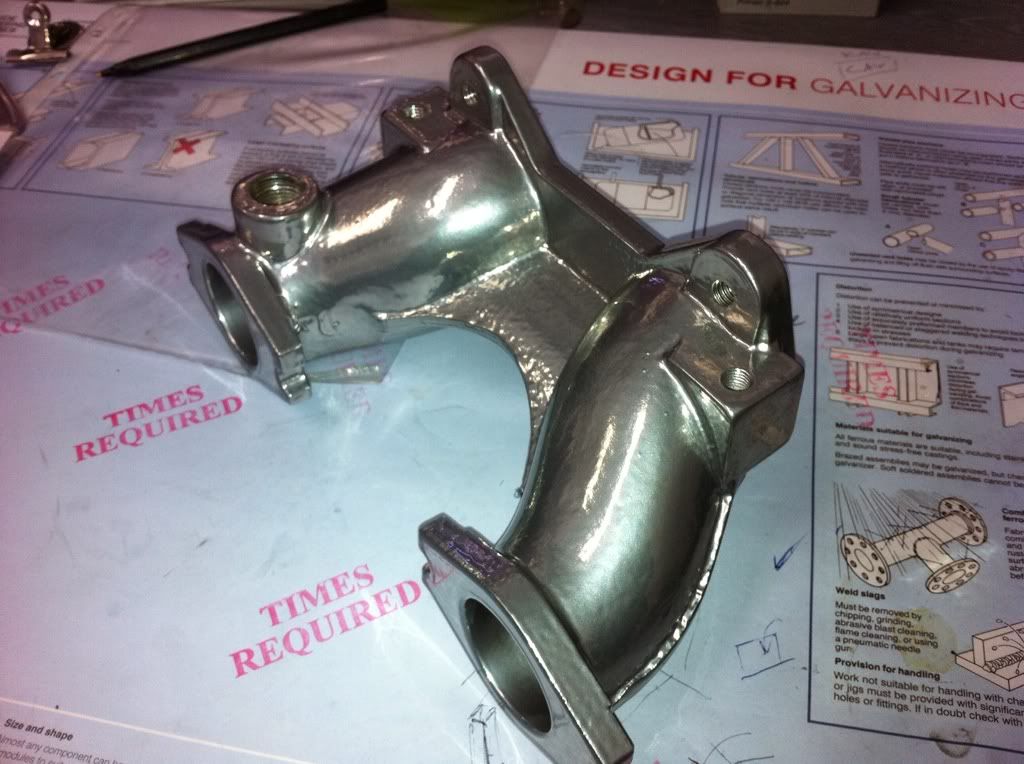

This has been done in a Chrome look powdercoat and then clear coated ( powdercoat) to .. speak to your powder coater and they wont get stuff everywhere .. mask up before hand and replace the bearings inside the housing ..
i also did my inlet manifold ..
