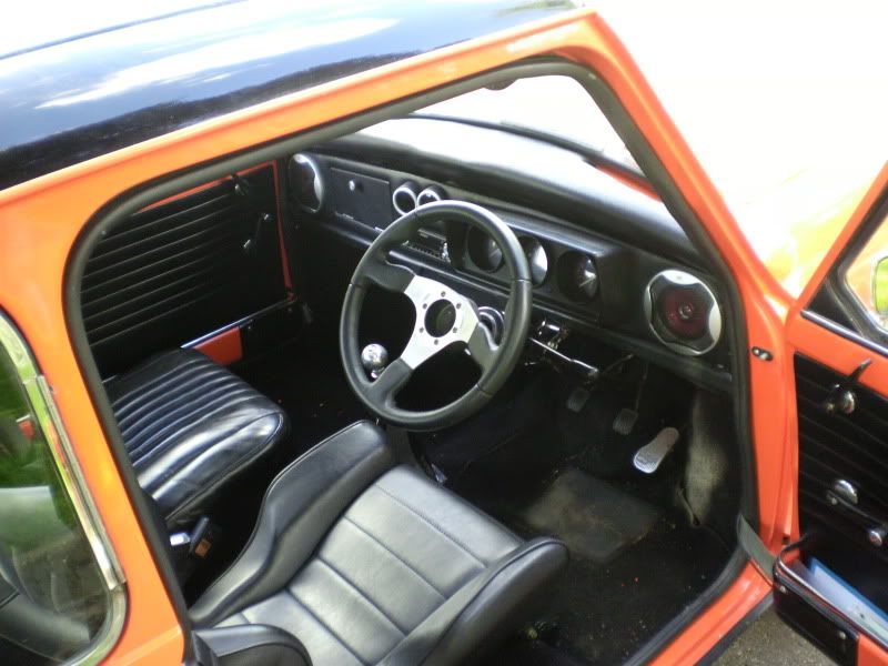

When i converted my mini K to clubman Dash I built a panel out of tin and covered it vinyl. Filled in the area to the right of the speedo nicely with oil gauge.
Though i had to mount it with screws from
under the wheel arch.
Cheers Rob

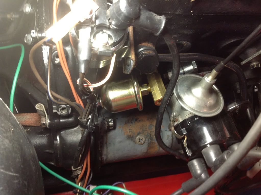

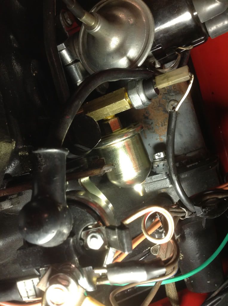

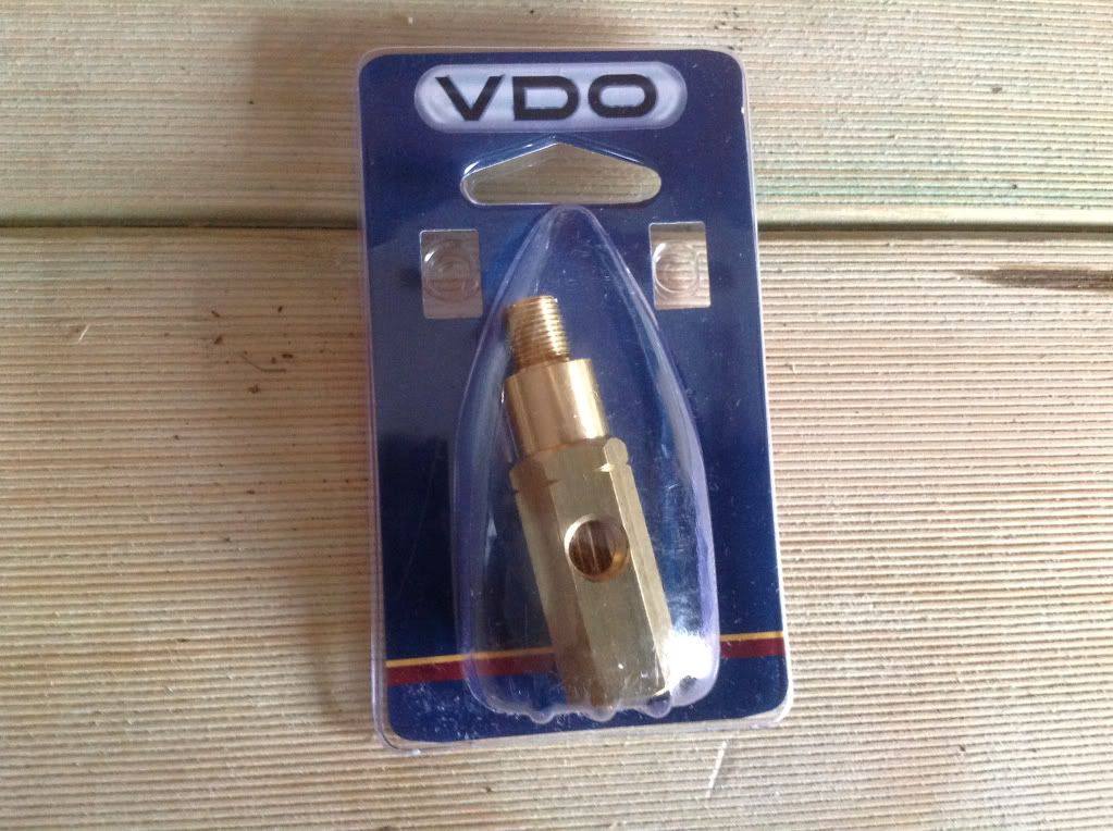

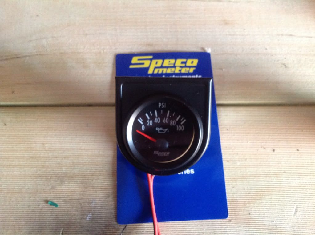

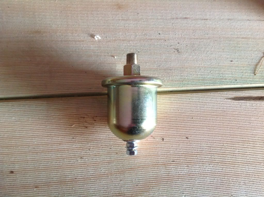

So I've decided to post some progress shots of me installing and oil pressure gauge to my mini so hopefully it can help others on the forum.I bought a speco street series gauge for $60 , a gauge holder for $5, a t-piece connector so I could retain the oil light.
This is an electric gauge so it came with a sender unit that will screw in to the t- piece

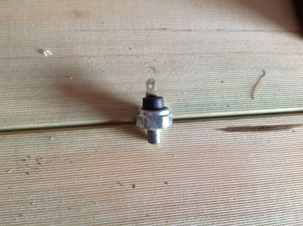

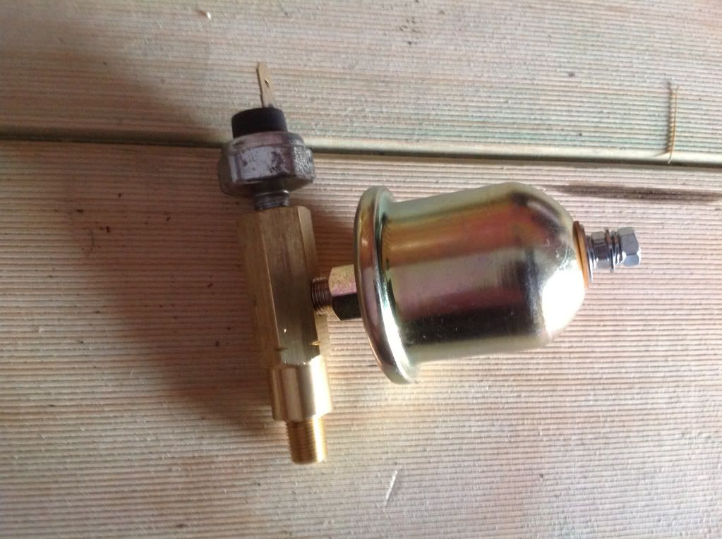

This is the oil switch which is originally in the block.

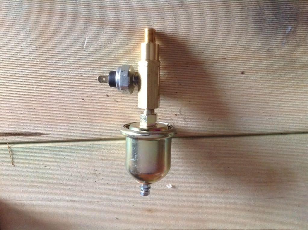

This is the t-piece that will let me be able to retain the warning light and have the extra security of the gauge.Image
This is it all assembled , note all the threads are the same on the switch on the sender and on the adaptor. I tried it two ways to see how it was going to look and to check all the threads.

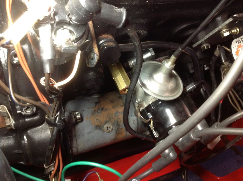

I then checked that the adaptor fitted in the block and then I sealed the thread and fitted it.
I then fitted the sender and the switch
I then ran the wire from the sender into the cabin thru the same route as the original wiring. To connect to the gauge. I will post the rest llater when I do the final fitment in the cabin.
