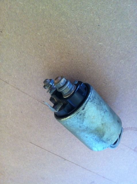

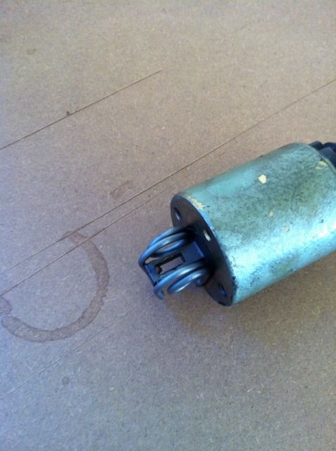

This is the solenoid I am referring to.
I'm guessing the arm out the back is used to engage the starter?

PostPosted: Sun Sep 02, 2012 4:15 pm
it is a pre-engaged starter.
The solenoid first shifts the pinion into mesh with the ring gear, THEN closes a pair of copper contacts to provide current to the starter motor.
I had trouble with one of those MG Heritage supplied geMini starters on Barney, the starter kept spinning when the switch was released.
I took it back but they couldn't duplicate the problem.
They are a Chinese copy of the Hitachi starter used on a Gemini, but I doubt if are as reliable.
Sounds to me as if the copper switch contacts inside are burned. Or, the pinion is not going into mesh properly to allow the switch to work.
An auto electrician (convertible mini?) may be able to help with a replacement Gemini solenoid.
