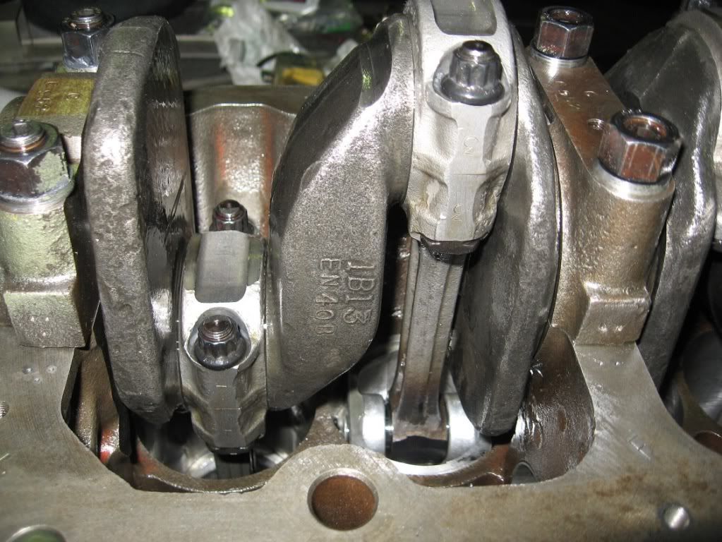

PostPosted: Thu Aug 23, 2012 10:34 pm
Posts: 950
Location: brisvages
i used the ARP studs , just dont use the washers on the ends, and machine 4 mm off the stud.
you can see the washer and the length of the standard arp set up, no good so remove the washer and cut the sud down at the end that goes into the block
