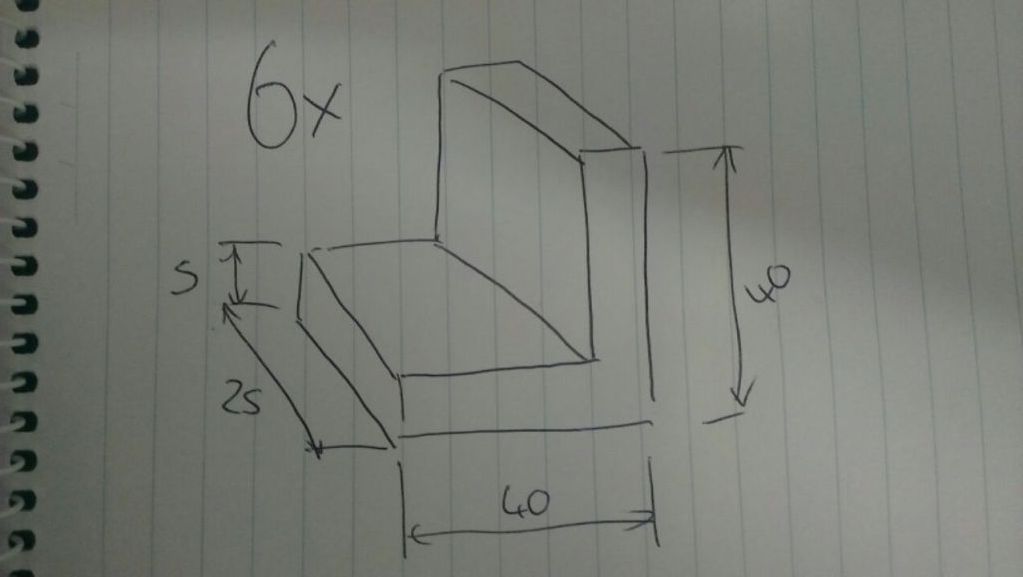

i need some steel brackets made up and i am not sure where to go.
Does anyone either have the ability or know somewhere that can do them for me??.
Here's a pic of what i need.
I need 6 of these.. ( measurements are in mm).

Tim,
Correct me if im wrong but wouldnt they just be 40 x 40mm (5mm) equal angle cut at 25mm long?
Just ask the steel merchant to put them on the saw?
Shane
PostPosted: Tue Sep 18, 2012 4:06 pm
Yep, that is a standard size as 40 x 40 x 5 angle.
If you need the square edge, use 45 or 50 x 50 x 5 angle and cut the tips back.

Oh, ok.
That should make it a bit easier.. :D
So if i just ring up a steel place, they should be able to help me out??

And they will usually cut to your sizes and charge you a cutting fee
