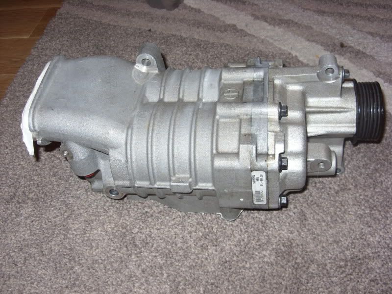

Mercedes version. Inlet and outlet are both pointing the same direction... down.
There's not enough room between the motor and firewall to rotate the whole charger 90deg.
Mini version. Inlet is perfect shape for a Weber (which is what i want to use) and points out the side with the outlet pointing downwards.

are there any integrally cast pieces in that downwards pointing extension? could be an opportunity to lop it off and weld a flange on there, then you could stuff around with manifold design without too much bother.
or rotate the elbow and have the carb pointing directly up :twisted: cut a hole in the bonnet. im sure the police wouldnt mind :lol:
[/quote]
I see what you mean, but I guess you could cut that intake off and weld your own flange on
the bini M45's look to sit very close to the bonnet, would you be able to get a weber beside it?
