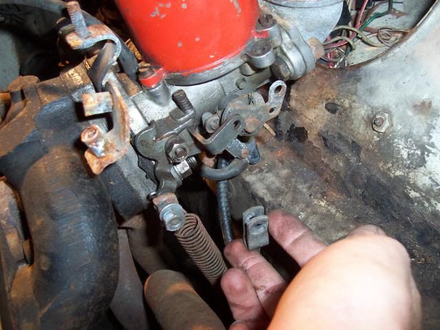

With the auto box, where is this link bar ment to connect to on the carby?
