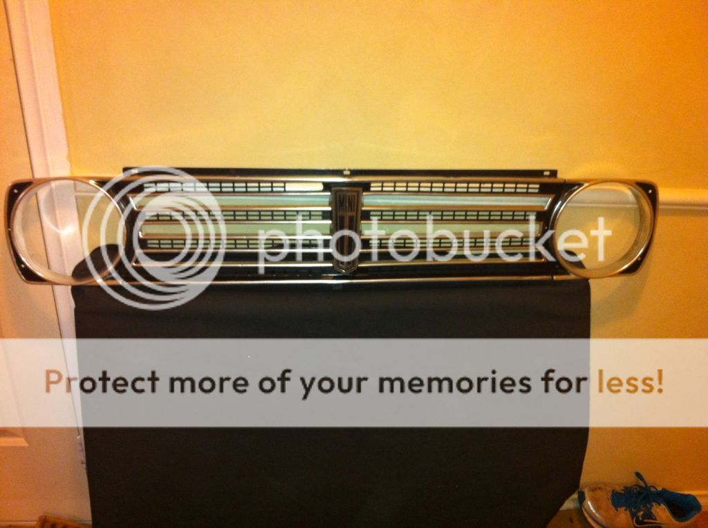

Thanks for the replies. I bit the bullet and did it myself. About $50 worth of products and a bit of work. Here is the finished product. I spent quite a bit of time bending the grille back into shape.

PostPosted: Wed Nov 07, 2012 1:41 pm
Joined: Thu Sep 27, 2012 12:49 pm
Posts: 42
There you go...It was easy really. It appears to be some sort of anodised aluminium alloy so is quite soft and easy to reshape by hand back to the shape it should be in. Autosol metal polish to clean up the exposed anodised sections (*Note* - the stone chips from 30+ years of driving will not polish out. Only replating will take care of them, but I am building a daily driver not a showcar so I was happy with polishing only). Once polishing is complete paint strip back to bare metal. Mask up the non painted sections (I bought a roll of painters masking tape to ensure a sharp paint edge. $10 very well spent!) and use a scalpel to cut aout the tape from the fiddly areas. Then spraypaint away applying a few light coats. I did 4 coats of each colour. I matched the red at a model shop to get as close to original as possible.
The most important thing is patience. I restripped and painted the centre emblem 3 times till I was happy with the result, and the headlight surrounds twice.
