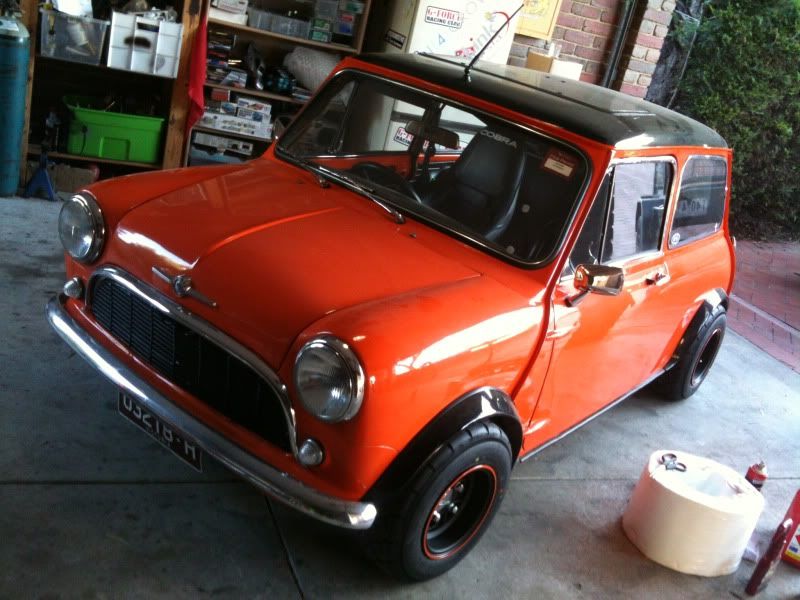

Pfft I've had 5's and 6's and neither on them feel any different.. Get what you want, I have 6's on mine and they're just about covered by wood and picket flares, probably illegal, but nothing legal ever looks good.. They're a nice looking wheel but everyone has them now hence why mine a matte black with orange pinstripes.. Had to change it up a bit..
On midland wheels themselves, awesome! Easy to order from, fast delivery and super cheap.. I bought mine with a032r's and the price was amazing! Only little thing was they were packaged a little lightly but apart from that.. No dramas, would buy again tomorrow.
