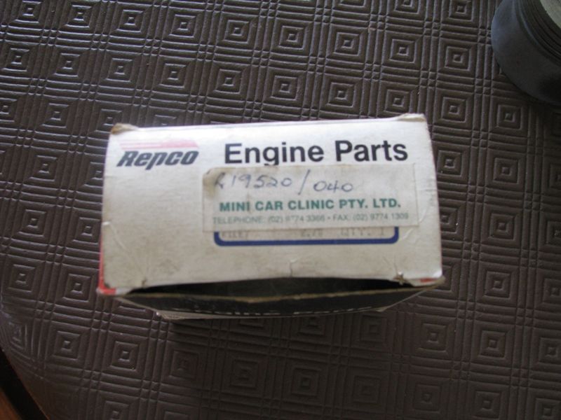

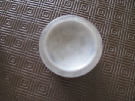

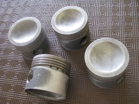

These are good 1275 +40 pistons with new +40 rings. Make me an offer I don't have a need for them. I'm sure someone on here will give you an indication as to what you should pay?

Cheers for that, they do have quite a dish in them. I was going to put in flat top, or semi-flat top pistons. The ones I have at the moment are 30thou Morris 1300 pistons with the same dish, but I think I am losing too much compression. My S pistons were too buggered to use again, so I was going to bore to 40thou and do the flat top thing.

I think you'll find most 1275 + pistons all have a dish in them.
