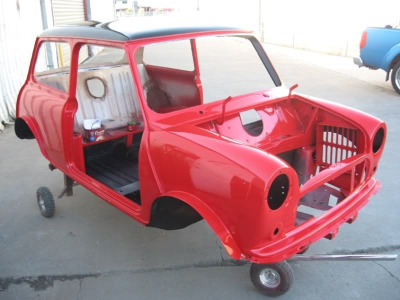

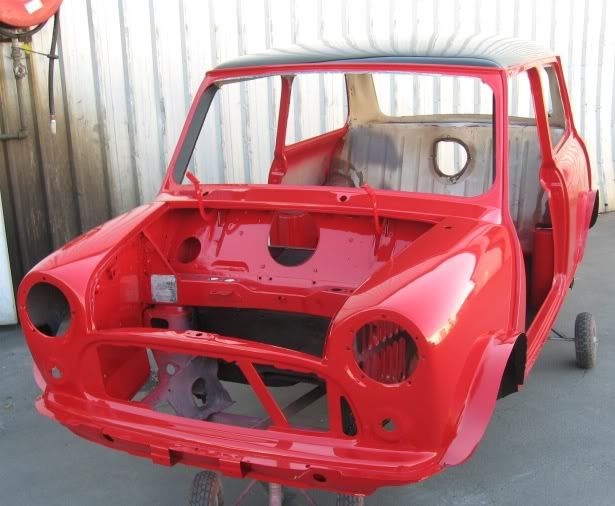

PostPosted: Wed Dec 26, 2012 12:39 pm
http://www.ausmini.com/forums/viewtopic.php?t=41844&postdays=0&postorder=asc&start=15
I've done it. Not hard really.
PostPosted: Wed Dec 26, 2012 1:23 pm
Posts: 750
oh, I assumed it would be more trimming than that!

PostPosted: Wed Dec 26, 2012 4:54 pm
I did trim a little more later when I started doing track work.
Very low, 13x7s with Yokohama A048 semi slicks - found it still rubbed on top of the arch on the driver's side :oops:
Better to trim too little than too much. Also I treated any exposed metal with phosphate
