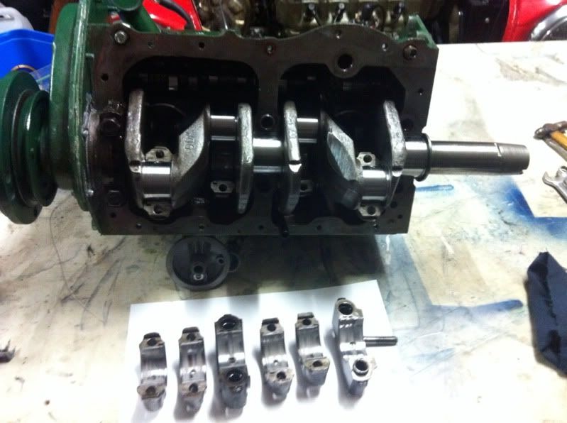

With some time at home, I've pulled the engine out of the 997 Cooper.
The engine was rebuilt two years ago and I noticed the problem straight from the beginning, but haven't had time to pull her out till now.
The problem is that initially the oil pressure is fine, actually quite high (80PSI plus at idle) once the engine comes up to temp it then sits around 50 PSI at idle, but then take the car for a drive, and oil pressure drops at idle only to below 15 or 20PSI. That is only at idle however and not at any decent revs over 1500. I have heard that oil pressure of any sort is fine, but to expect 50 and get 15 is a little too much to leave alone.
I played with the relief spring and valve, I've played with oils and most other things I could while its together to try and work out what was going on.
I've got the engine apart now (now I've got my snazzy new engine crane) and I was hoping to find a set of buggered bearings, but as you can see in the images they're fine. No gouges, just a little polishing. Perfect in fact. So now I'm at an end. I've got an idea of (perhaps?) opening tolerances in the oil pump maybe? Could I be losing oil in the top end? Anyone got any ideas?

Those bearing shells don't look too hot now, I'd change all them too. Are cheap.
I like ACL Duraglide ones these days, made in Oz (tassie). 8)
PostPosted: Sat Dec 29, 2012 8:41 am
Ok, will do.
In the flesh they are they are however very good. There's no scoring even if the photos don't show up well.

I would have the crank journals measured.
My Cooper S had exactly the same symptoms as you describe and the crank was on the outer limit of the specifications. I have since had the crank ground and now I have around 50lb when hot @ 1500 rpm.
My crank looked OK with no scores or marks, just worn after over 100 thousand miles. :wink:

PostPosted: Sat Dec 29, 2012 5:26 pm
Hi Michael
I made these measurements last night and got the following:
- Big ends come up as 1.595-1.596 at smallest measurement (30 thou under)
- Mains come up as 1.721 at smallest (again for 30 thou under)
