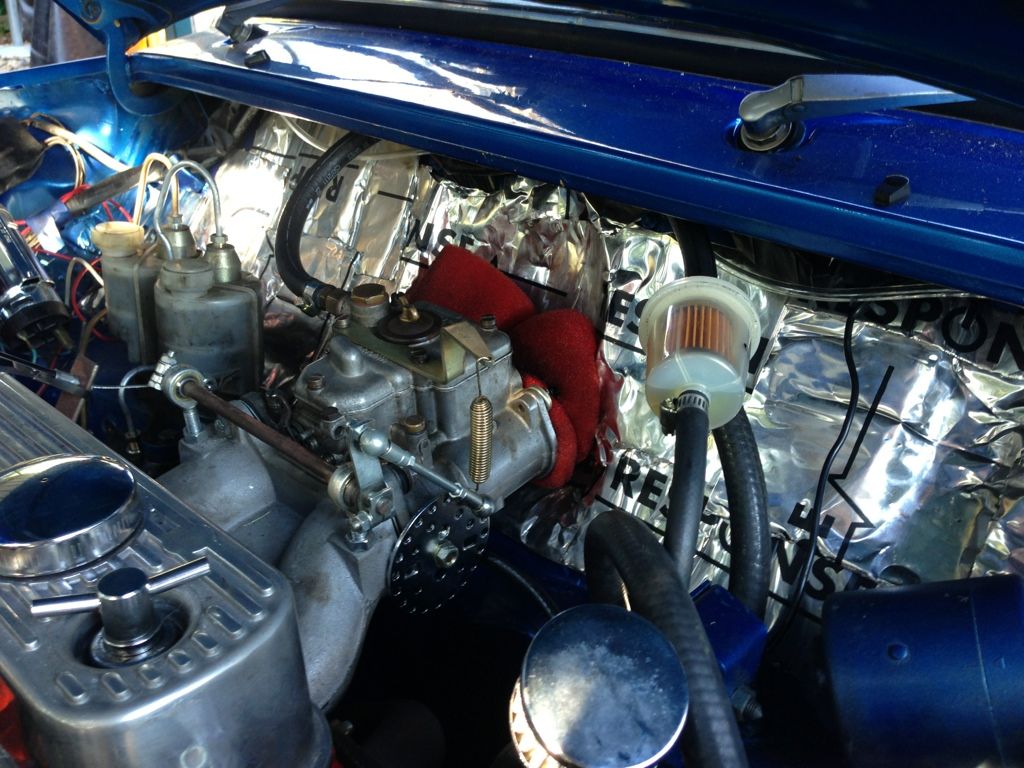

Tight but works!
PostPosted: Tue Jan 01, 2013 12:17 pm
Yeah but not well, it's 50% squashed in.
a Ramflo case + Unifilter foam + my stubstacks would flow heaps better.
