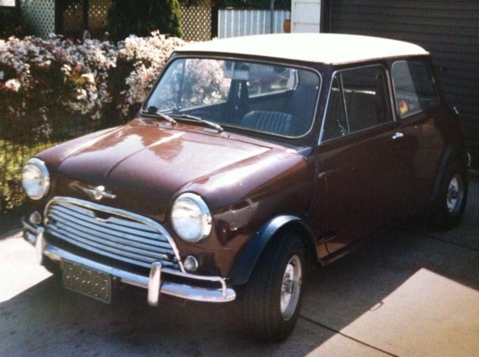

By the way would give both my nuts and a years wage for this mini if anyone knows of it
Burgundy Red,
Mini Deluxe
YMA 2S3 Body Number 31684
Yes Burgundy Red not Special Burgundy
