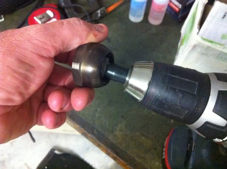

I think its still worth lapping them a little, even if you don't go to any great pains to do so. They bind up so easily without the ball joints being lapped in, so may give false reading as you shim them up.
I put the ball joint in a cordless drill and spin it up for a a few seconds with a little paste, then wash it out. Laps them in in a tick.

Mick, that's how I was lapping mine too.
