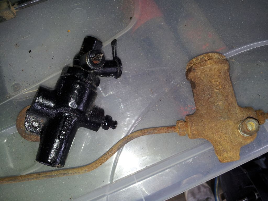

PostPosted: Fri Jan 25, 2013 12:16 pm

The Mini King
Posts: 1338
Location: Windsor, NSW
TheMiniMan wrote:
Hi Matt I am Fairly sure the one on the right is Morris 1100
PostPosted: Fri Jan 25, 2013 12:39 pm
Posts: 658
Location: NSW
TheMiniMan wrote:
Thanks Matt, so both those are Non Cooper S.
Does anyone have a pic of an S one with the rings?
We are getting closer....
Now with 2 extra ports!
I crawled under my MK II Cooper S's to take these. Can't see any obvious rings (except around the flange under the big nut) but maybe someone else can.
PostPosted: Fri Jan 25, 2013 2:38 pm
Posts: 658
Location: NSW
Great pics, thanks for your efforts!
Probably hard to read any numbers on it..........
