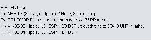

Here is there list I got from Dr Mini a while back
They are available in NZ
Ta
Kiwiinwgtn

sorry should have read the post correctly
Basically the AH-08-06 Nipple needs to have the thread recut on the end to a 5/8 . The hydro place may be able to it for you.
The cost should be $60.00 nzd from Pirtex
Ta
Bernard
