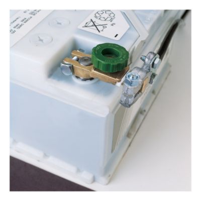

Currently my car has the type of switch that is part of the negative terminal on the battery. The type where you unscrew the knob to turn off power.
Works well. Easy to fit. Easy to use. Extra security if you lock the boot.
EDIT: ...heres a pic.
