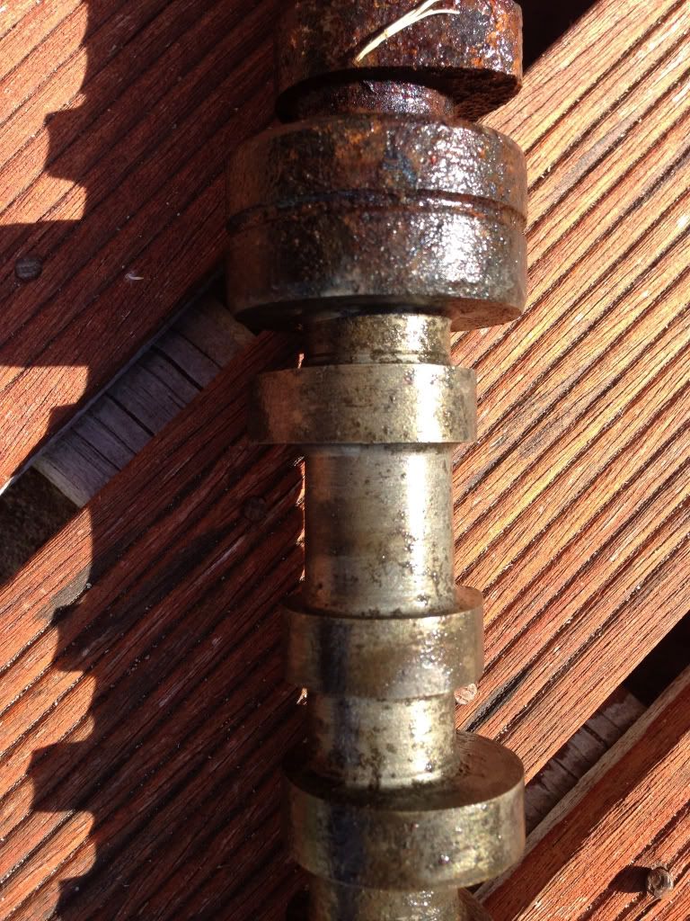

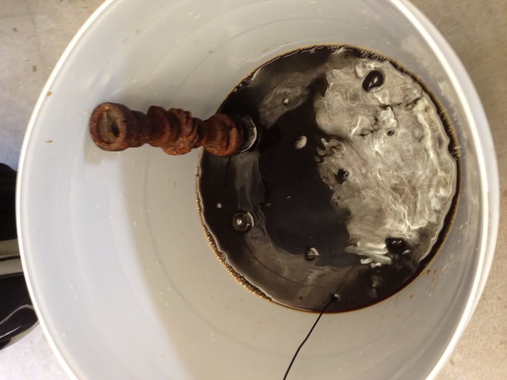

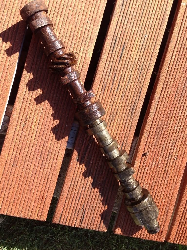

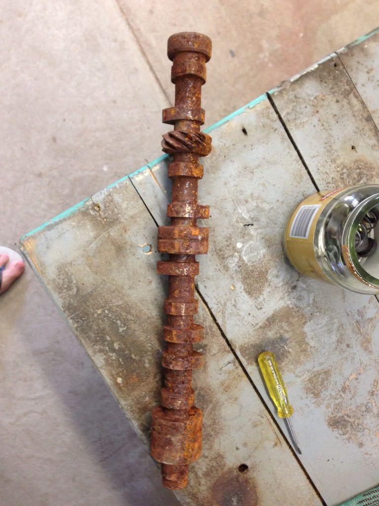

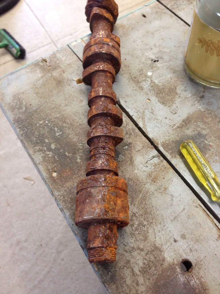

Hi everyone thought I would post some pics of the molasses rust removal trial. I thought that I would give it a go on a rusty old cam I had hanging around see the images below.
Starting point
Sitting in the bucket of 1 part molasses 9 parts water
After 2 days in the bucket I was really surprised, a quick hose off with water and a light rub with a wire brush
I have put it back to soak for 2 more days and see what happens. I will post some more progress pictures after I pull it out.
