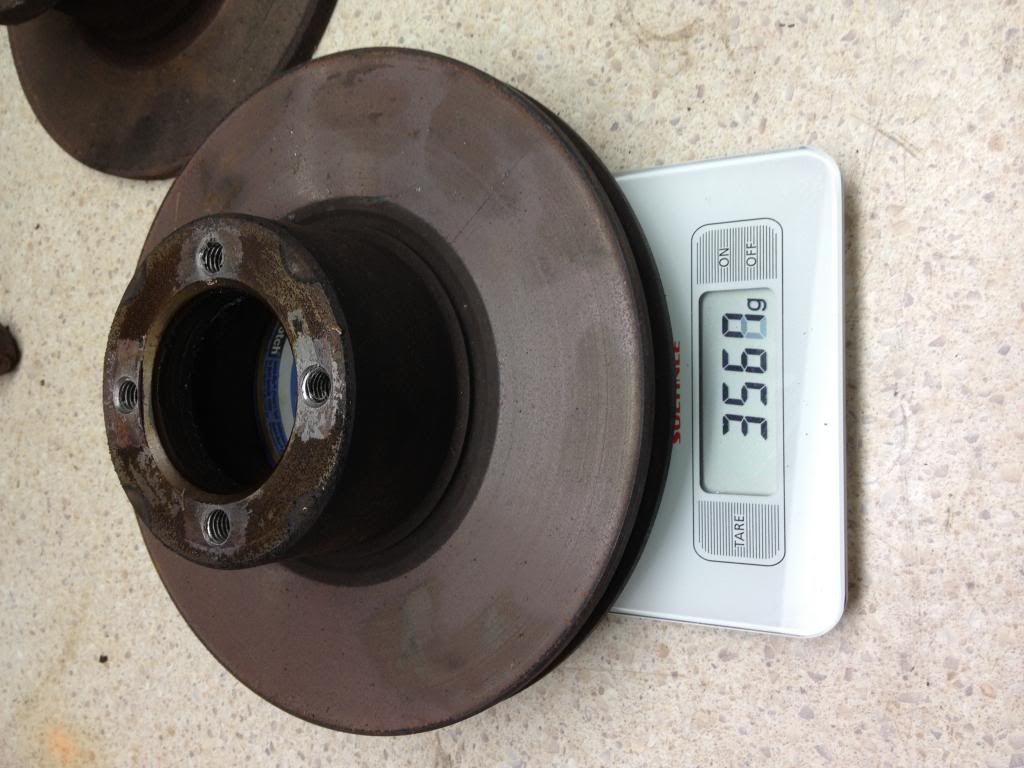

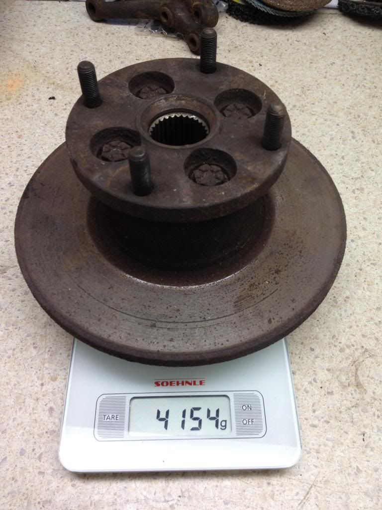

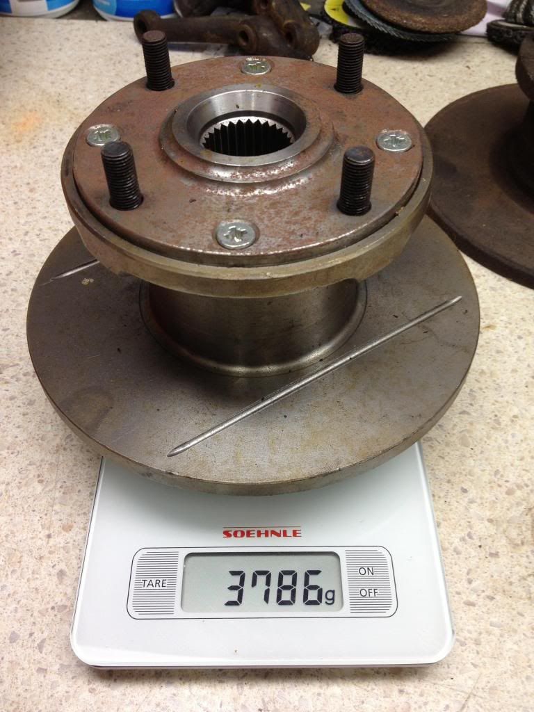

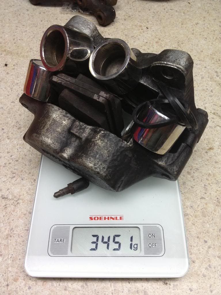

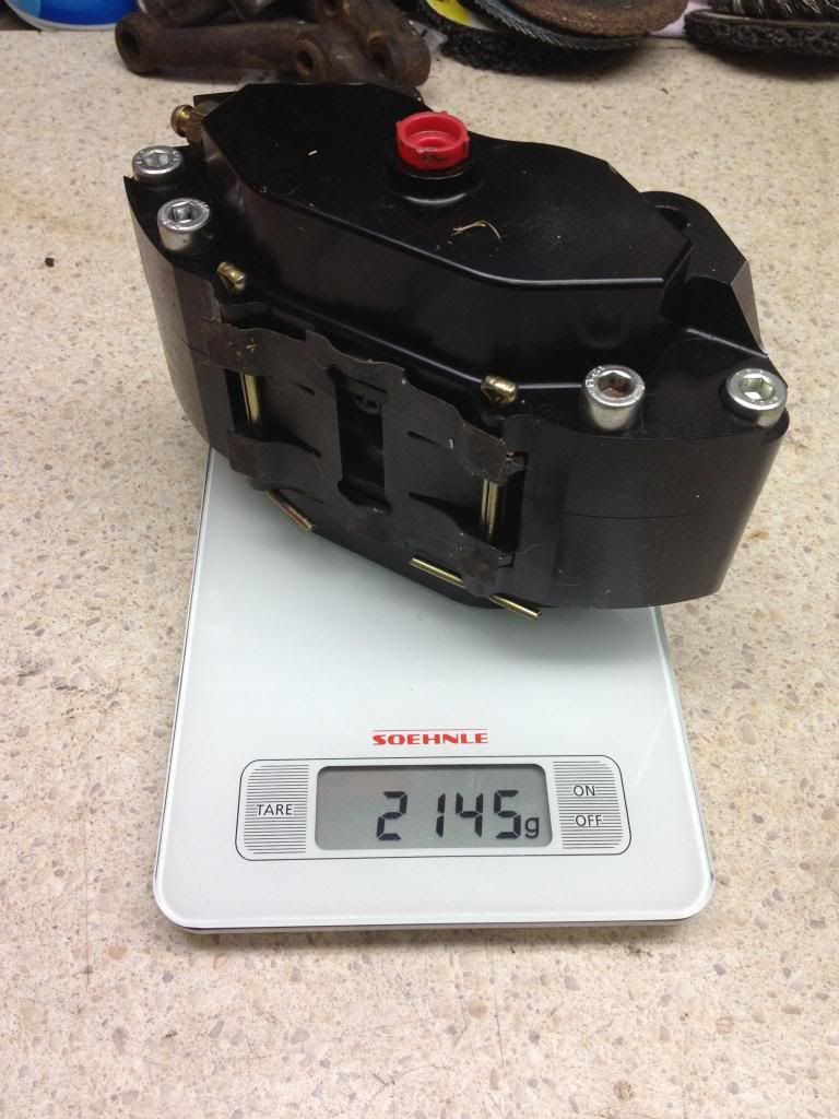

Ok I have weighed the following:
8.4 inch solid disc and drive flange with screws and studs 4154 grammes
8.4 inch vented version of above with metro drive flanges machined to suit mini 5284 g
7.5 inch solid disc and drive flange with screws and studs (cooper s) 3786 g
4-pot alloy minispares UK calliper to suit 7.5" cooper s with pads clips etc 2145 g
8.5 inch 4-pot metro turbo iron vented disc calliper with pads clips etc 3451 g

The metro turbo 4 pots are for vented but they would be a fraction lighter if the calliper half spacers were removed to suit solid discs.
The metro drive flanges have has the big castellations machined off the wheel mounting face but the large outside diameter has not been trimmed down.

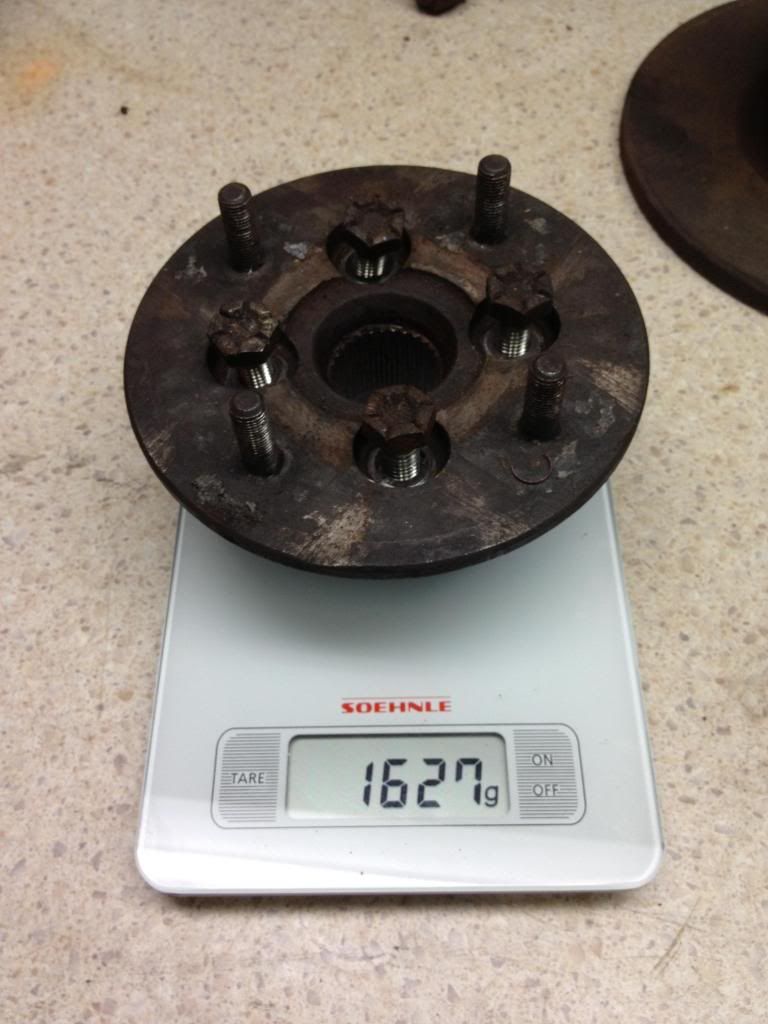

Here are the pics:
The scales max out at 5kg so I had to split the metro vented disc from drive flange.
