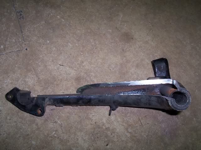

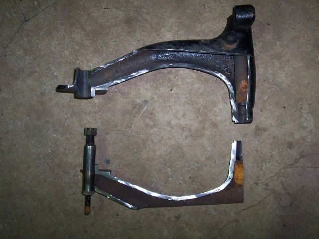

PostPosted: Sat Mar 02, 2013 2:18 pm
Rear arm sectioned and steel tube in-suit for those interested;
