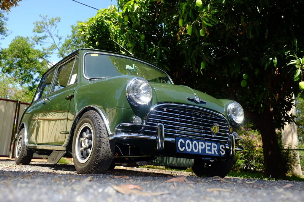

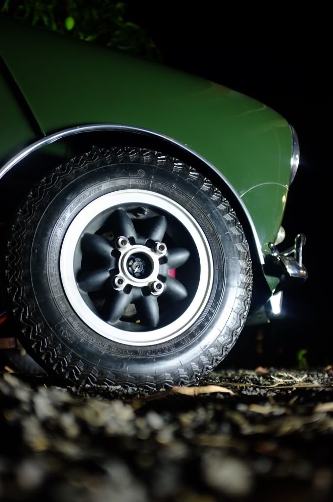

I am running 7.5" disc brakes with out flares.. Not sticking out, using rosepetal mags

There are a number of alloy wheels that fit over 7.5 discs without the need for flairs... The pictured "rosepetal" style as well as the Leyland ROH type, 4.5 FIA Minilites and MSpares Minilifes...
