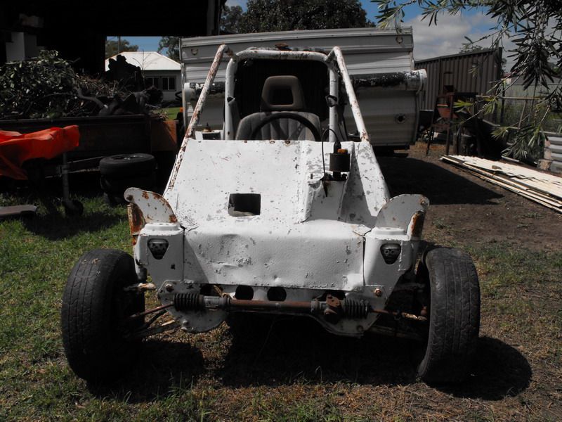

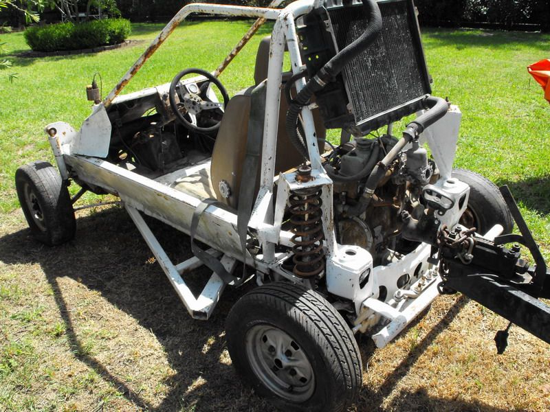

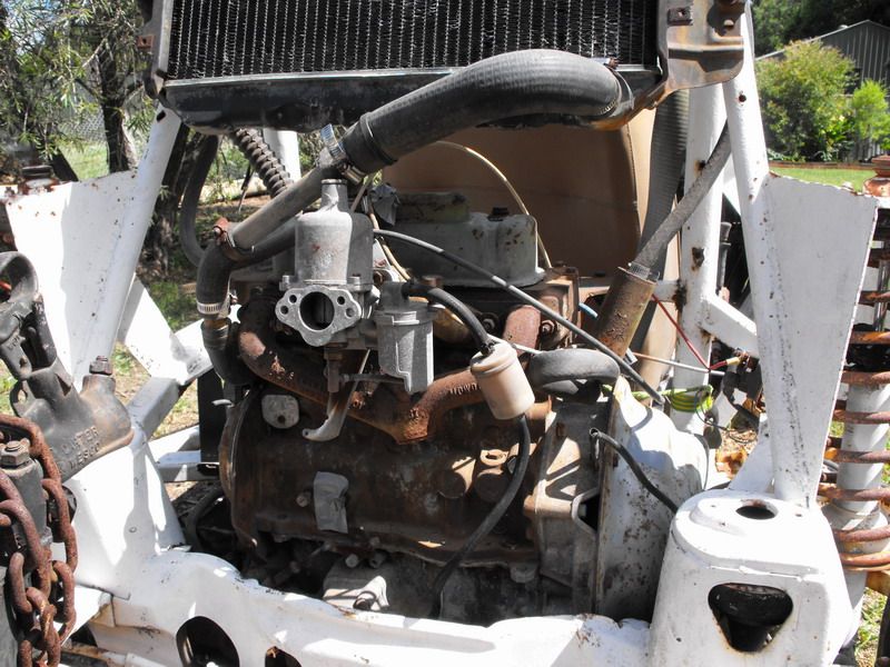

I have just scored an old buggy that has a rear engined 1275 auto in it .
Engine no : 12YE / A / H xxxx
Dizzy No: 29 D
629 11 971 A
AYG 2153 3 69
I'm assuming from above comments that the motor comes from a march 69
Morris 1100 / 1300 .
It hasn't been run for some time , going to try to fire it up , not sure what í'll do with it ,
rough idea of what they'd be worth ? I'll see how i go with some photo's ( if i can figure it out the posting side of it ) .

Goodie can now post pictures
(tonight at least ) :D

That buggy looks fun but I'd toss the autobox and fit a 4 synchro manual instead.
And also mod the motor for more mumbo.
Autobox sucks too much POWA! :evil:

It May be a lot of work tofit the gear change though Kev

John I used to build Formula Vees, so a gearshift would NOT be a problem.

My brother actually scored the buggy , he's known about it for a couple of years .
He told me that it had a 1275 in it , so i asked him what he was going to do with it ,and
he said sell it , so i told him that i'd buy the motor out of it .
Well , we went out the other day to pick it up and thats when i noticed that it was an auto , unfortunately it has been sitting in the weather for 12 months so a couple of things need some attention .
Basically i'm going to try and fire it up , see what it does , whether it drives or not and then decide which bits i want to keep , take the engine out , get rid of the tranny
and palm the buggy off .
What engine / gearbox oil do these things take ?
