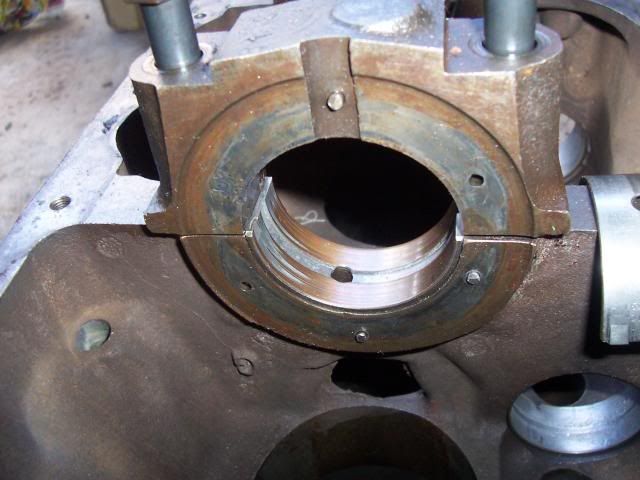

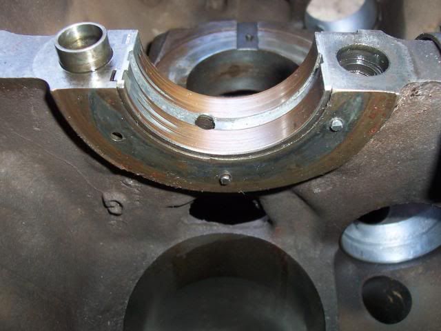

Some pics now;
Their is still a tiny lip left but not enough to do the job. Also is the dowel up the top ment to be their :?: it's on both sides of the center cap.
PostPosted: Wed Mar 27, 2013 6:08 pm
Posts: 39756
The slot in the cap is normal to locate the thrust washer, but not the dowel.
I'd be pulling another block off the pile in the corner... :wink:
I bet that worn face shown is not flat. There are ways to fix it properly, but they all involve machining, spending more than another block is worth.

Bearing shells look pretty stuffed too, and in an odd way. I wonder what the crank alignment is like.
PostPosted: Wed Mar 27, 2013 7:26 pm
yukko - wonder how that came about...
PostPosted: Wed Mar 27, 2013 7:37 pm
Posts: 39756
Happens when people fit the thrusts in backwards, the crank wears the thrust out so it's thin, then the thrusts falls out, crank gets intimate with the block... et voila.

If I try this method what is the std thickness of the center main web :?:
and by my calculations this will only give it a 1mm lip at most (.7mm + the tiny lip that is still on the block) will that be enough :?:
PostPosted: Sun Mar 31, 2013 3:58 pm
Posts: 39756
Kennomini wrote:
Another way-
You could get that thrust face remachined deeper that side only, then use +.030" thrusts. These are still available (ACL brand, made in Oz) from Karcraft and others.
Probably not, if you get any wear after fitting.
I would be inclined to machine it back another 1.5mm and take the lip off, then screw and dowel a thick plate on there, then machine into that to give standard width, with an original size lip.
As I said in my last post above, this would probably cost you more than another block would. I have a couple of good std bore 1275 auto blocks if you are interested. :wink:
