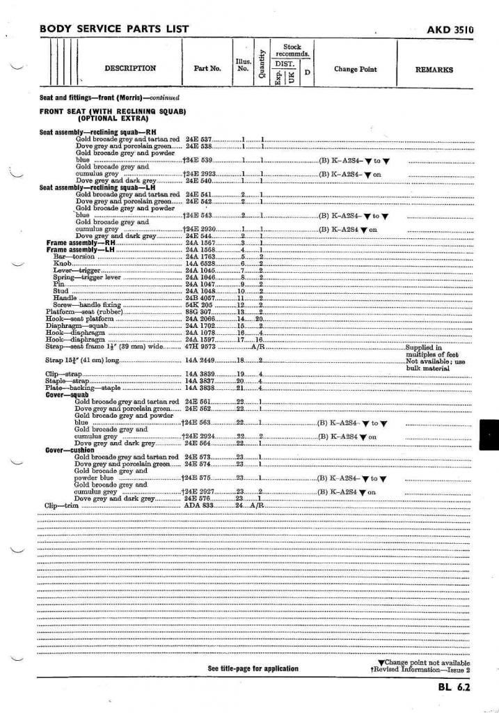

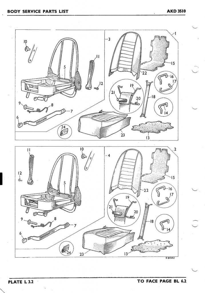

PostPosted: Sun Apr 28, 2013 2:24 pm
Posts: 6743
Here's the parts list pages:

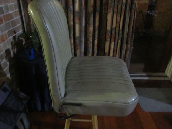

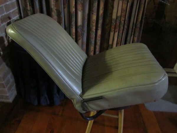

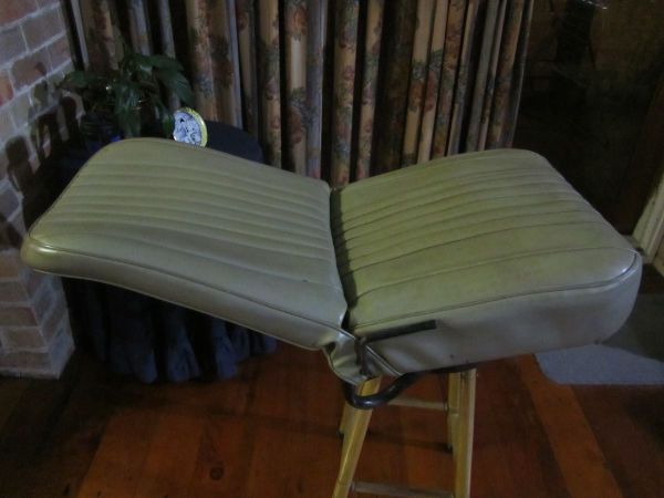

PostPosted: Sun Apr 28, 2013 7:38 pm
Posts: 6743
Some photos of a recliner another member asked me to post. Will let him follow up if he so wishes.
