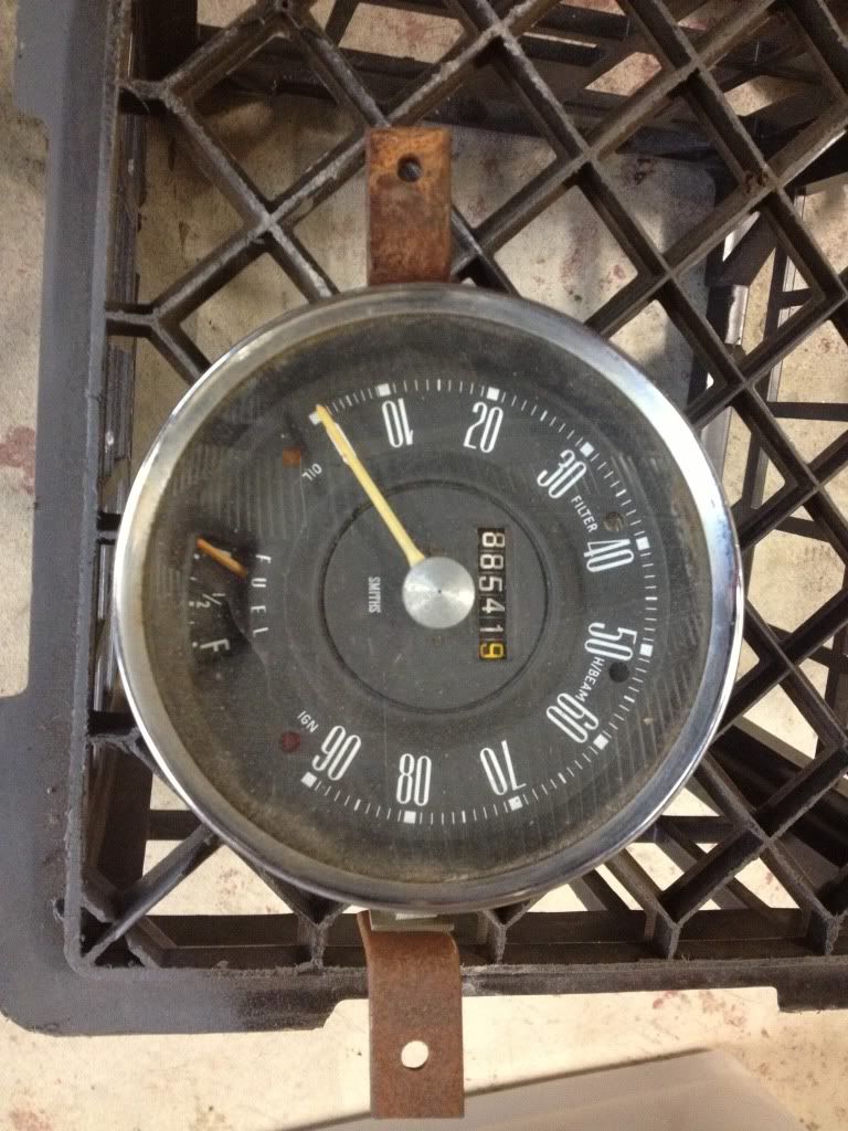

Hi guys this speedo came in a box of spares with my project just wondering if its correct for my 68 minimatic or if I should chuck it into the for sale section ?

It's a mini k speedo from around 1969 on! :)
It looks the same as was in my 3/70 matic.

So if its from a mini k what style should I be looking at for a 68 matic or would they be the same ?
PostPosted: Tue Jun 04, 2013 7:24 pm
Posts: 39760
Same.
Only difference was the 69 on `matic had a Mk2S speedo binnacle, with temp and oil pressure gauges.

I thought a deluxe speedo was like this? Slightly different as it has central white rings and white needles and were Smiths UK made?
That is not like any Mini K speedo I have ever seen.
Filter, Ignition, High beam and Oil light windows are not correct.
Mini K only had High beam and Ignition light Windows....
It is from 69 or 70 but is not from Mini K.....

My Guess, Australian Made Mini deluxe speedo
Which would make it late Deluxe- around 1968? Would it then be correct for a 1968 `Matic?
I've just compared it with photos I have of a very original mid to late 68 mini matic and it is fitted with the same speedo.
Yes it would and early 1969 models (pre June )
I am not sure however if the RPML is the same

looking at the last photo it has a ink stamp on the back the part number is often
in that stamp I would be very interested in knowing the part number if it is possible
to read it

I can get a photo of the part number stamp tommorow for you John
