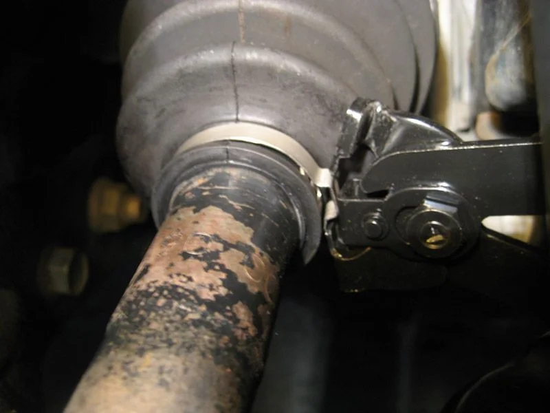

PostPosted: Tue May 14, 2013 8:32 pm
Posts: 633
Will you get those boots tight enough?
I was refering to these http://forum.ih8mud.com/attachment.php?attachmentid=193219&d=1196720553
Lillee wrote:
You can also get them from any CV place for very cheap. Note that you need different lengths
That''s a given but find me a CV place open late on Fridays or weekends.
PostPosted: Tue May 14, 2013 10:00 pm
Yeah you can, not with your fingers however. I use a pair of sidecutters and roll the handle with the band in the jaw to get the last few millimeters out of them.

I have a CV boot tie tool and it's easy as with it, so can't comment 8)
Only thing about Mick's type tie is that the thing that sticks out may rub up against the wheel hub in the case of using them for CV joints as well? All I remember is that it's a tight squeeze on the CV joint boots against the wheel hub on disk brakes. The metal ties tap out flat... But other than that they look the business
Plus I have like 100 of them which makes the decision easier too :lol:
Lillee - 1969 Morris Mini K
PostPosted: Tue May 14, 2013 10:12 pm
Yes that's true. I cut them off at about 10 to 20mm and bend them so they stay flat. They don't try to stand up really.
