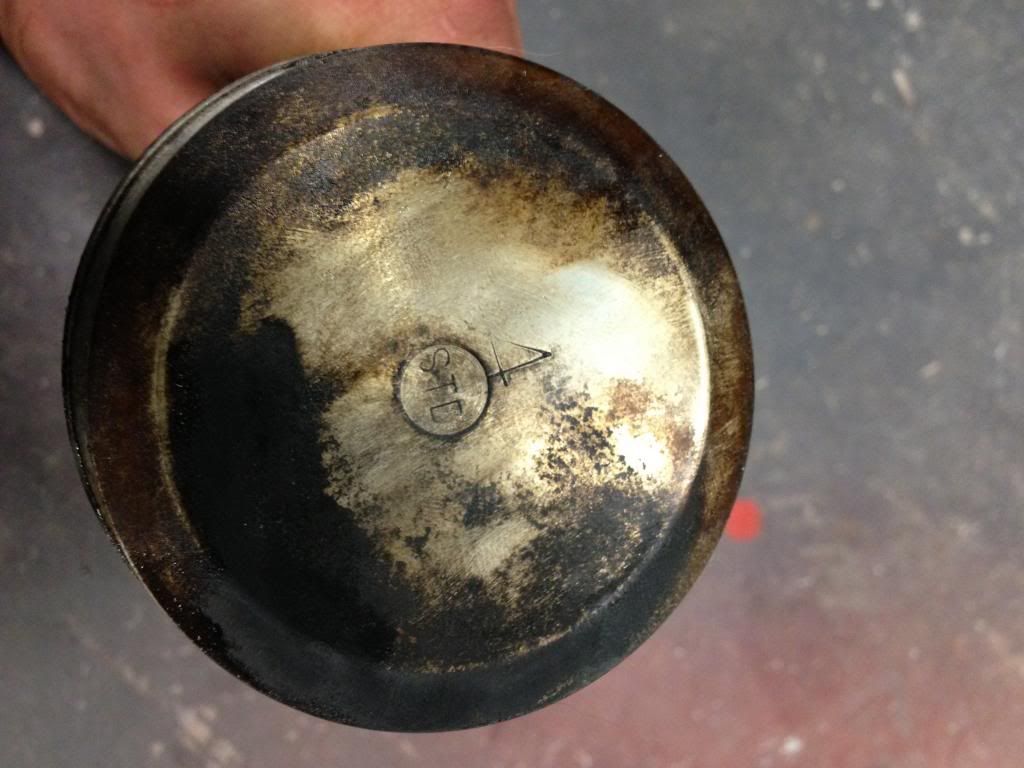

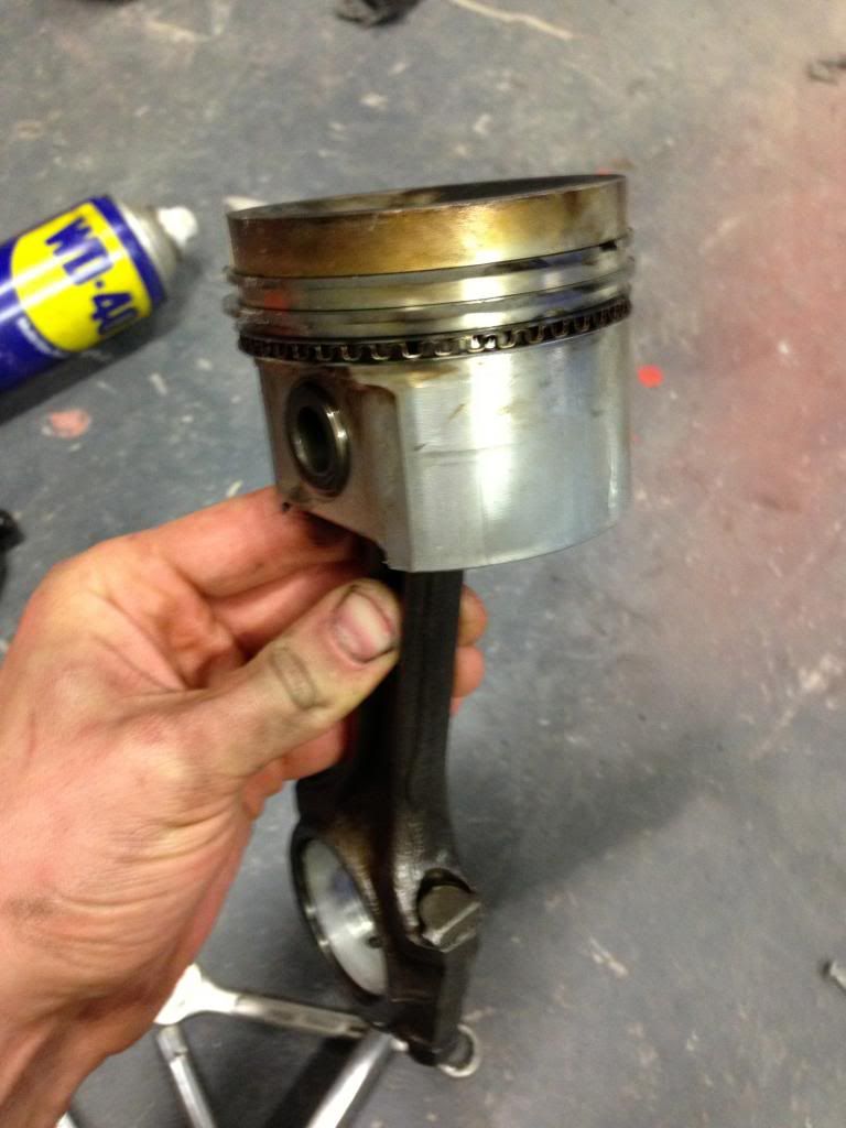

Just pulled the pistons out. Here are some pictures. Can anyone identify them? Receipts just say 73mm pistons. Sorry about poor pictures

definitely are Hypatecs.
You can use Hastings rings (from Karcraft, Minis Plus or Minisport.au) or Nippon rings (from Russell Engineering).
