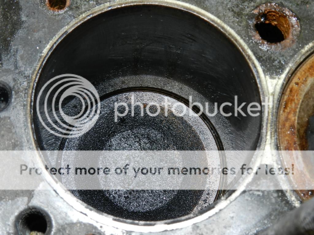

Ok so I have always wondered about the history of the motor in my car.
I have the head off today and measured the bores. It is 72.0mm or thereabouts and standard stroke which I think equates to about 1324cc. It also has dished pistons so could be more.
No wonder it goes pretty well.
I'll post a photo later..
**Edits below**

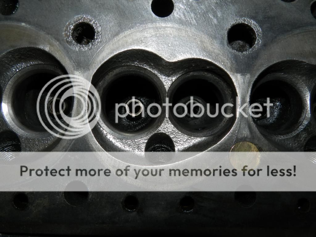

Ok so the cylinders look fine except for number 3 which obviously had the water going in it. The gasket was an aluminium based one and prettty Carp by the look of it.
Looking at the head it is a 12G1316 with what looks to be standard pprts.
The chambers look ok so I'll finish de-coking them and then think about opening up the ports touch
Any ideas about cleaning the inside of the head while it is off? Is s soak in CLR ok for this job?
Ill also have to give the block a good flush.
Anyway any comments welcome.
The carby is still great (just needs a tune by Matt)
Alec

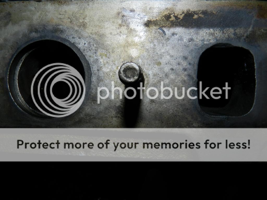

PostPosted: Sat Jun 08, 2013 9:03 am
Posts: 39755
Those exhaust seats look pretty eroded, I'd be at least refacing them, or else fit unleaded inserts. They are too bad to just lap in.
Check all the valve stems and guides, if worn buy new ones. They are cheap as chips.
 Post subject: Block 1275
PostPosted: Sat Jun 08, 2013 9:27 am
Posts: 3022
Location: JIMBOOMBA QLD.
Does the engine number end with an S on this block??? Looks like a sleeved Block and valve guides have Liners! I could be wrong.

PostPosted: Sat Jun 08, 2013 3:19 pm
Posts: 1479
Location: Qld, Brisbane
I agree with drmini
Those exhaust seats look pretty far gone and they also look like they might be too far down for a grind/cut
 Post subject: Re: Block 1275
PostPosted: Sat Jun 08, 2013 8:34 pm
Posts: 749
Location: Brisbane northside
I dont recall there being an s after the numbers but Ill check..
It is weird in that the engine prefix is 12H897UH and then six numbers as opposed to 12H902.
I did notice the sleeves but not on the guides so well spotted Tony.
All the valves seem to be in good nick and dont seem to have any play on the guides. I'll measure the valves stems and if they are ok get new guides put in with the hard seats.
I'll be interested to see what the local place charges for putting the inserts and guides in. What do you guys normally pay for inserts?
Also on getting the inside of the head clean do any of you guys have a trick I can do at home or can the head shop do it?
Also whats the best way of getting the crud off the top of the pistons without damaging them?
Thanks for the advice guys.
Alec
PostPosted: Sat Jun 08, 2013 10:12 pm
Posts: 39755
Down here it costs about $160 to get 4 unleaded exhaust inserts fitted and then all 8 seats recut.
Those guides look to have K-liners in them already, if the valve stems are fine they should still be OK. They are better than stock guides as you can run less clearance without the valves seizing up.

Stems are fine and the chambers and ports cleaned up nicely.Now that I have all the gunk off, the inlet seats are all good but the exhaust ones are eroded. I lapped the first one to see what they were like and it did come up a bit but they'll be off to the shop this week for inserts.
As the seats for inlet and exhaust lookto be recessed a little, would you normally look to get inlet and exhaust done or just exhaust? Like I said the inlets look pretty good. The spots you can see in the pic above are grime and cast off from when I had started to de-coke the head.
