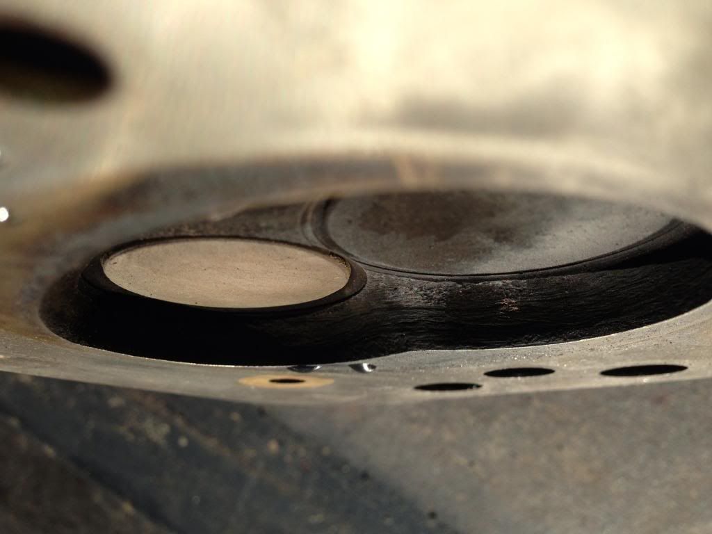

My new head also seems to have the valves deeper in the head than my old one. ill try get some pics.

Old head:
23cc
New head:
21cc
Sorry about photos being rotated
If its yours, customize it !

Interesting the old head has been bath tubbed, which in itself is a performance modification.
And the old head has life left in the seats and tapered valve guides.
Why not get GR to suss them (pm?)

Yeah i beleive it was done to lower compression.
Ill probably end up using the old one and possibly switch over the double valve springs onto it. Compression will be too hight otherwise. Maybe just go back to running valve saver just incase they arnt hardened seats.
