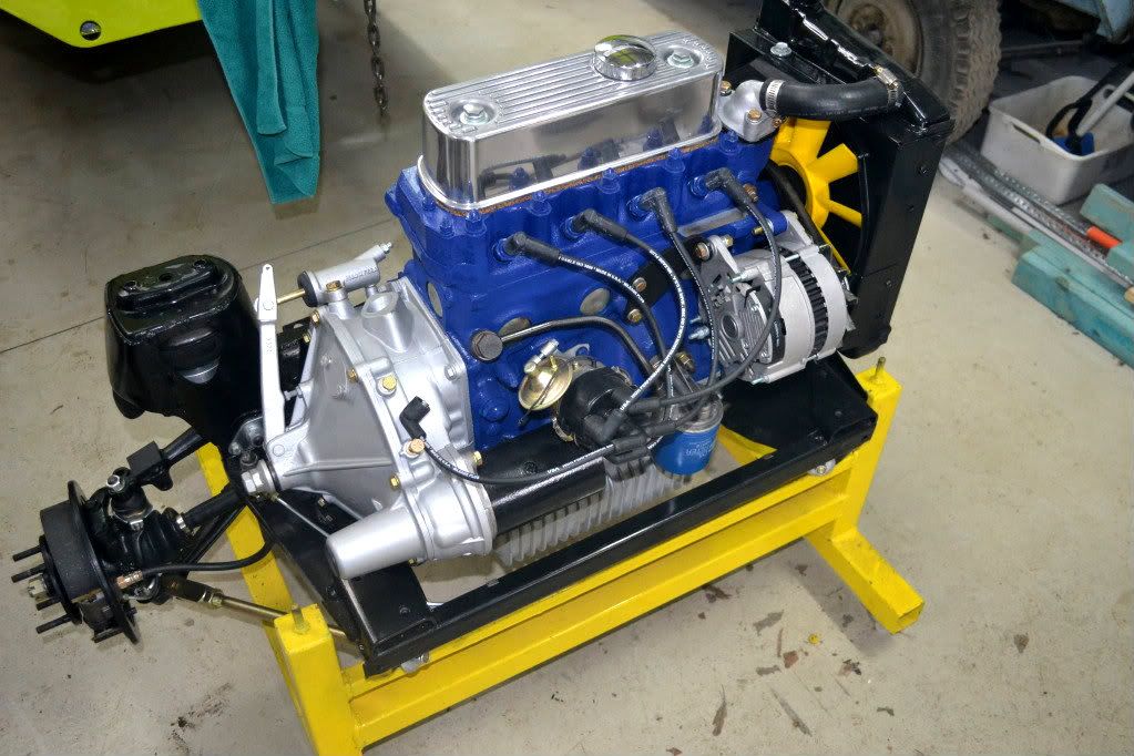

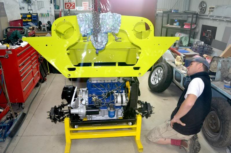

I built a jig that was posted on the Moke forum.
Have used in on several Mokes and cars. Back support has a sissor jack that makes the angle adjustable when lowering the body.
Last time we used it we had the whole unit in this Moke in 15 minutes.
The post on the front that you can see locate into older Moke subframes that have the front bar mounts. It has been modified to take regular subframes and has the 'Monte' engine currently on it.
Dave K.

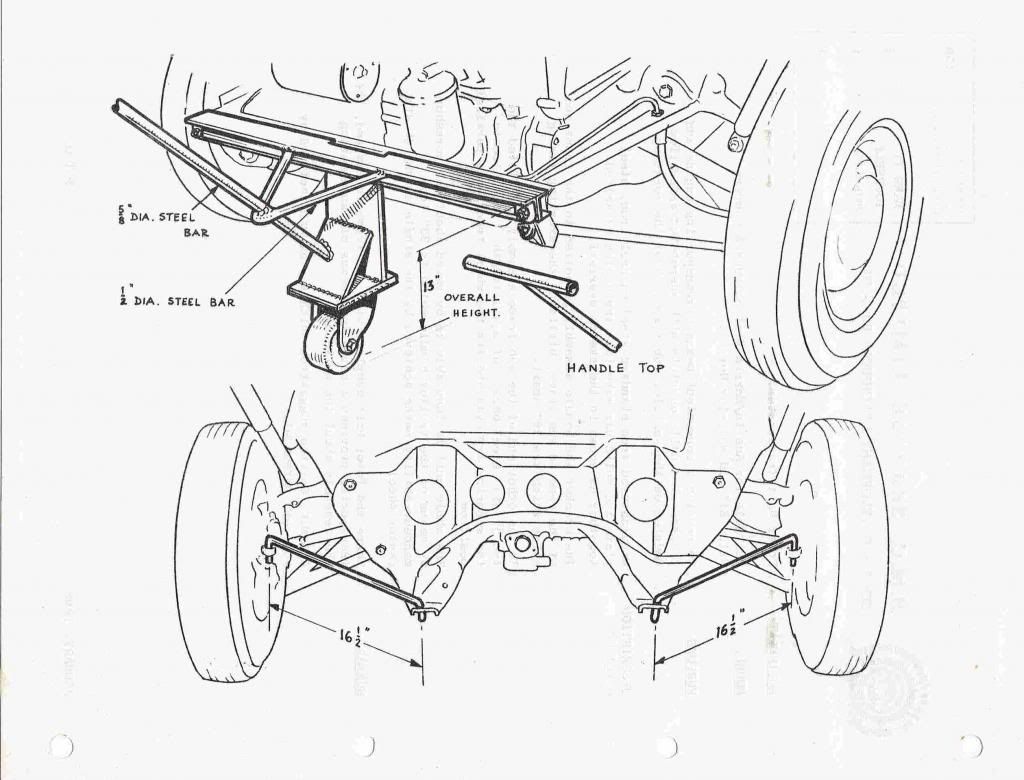

Just found this when looking through a Service Bulletin I found on the web somewhere....
(sorry quality out of my control).
(not useful for fitting/removing from body - but for general moving around...)
PostPosted: Sun Jul 07, 2013 3:40 pm
Posts: 6753
I scanned the originals so the quality is a bit better than that web version.
