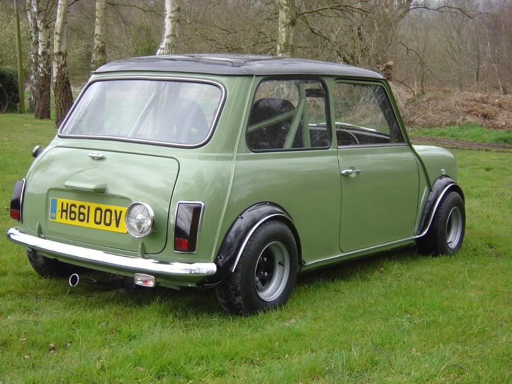

Guys
Can anyone help moreso with where to source these flares. I think they are group 2 wides but looked at karcraft today and their group 2 wides were not like these. The fronts were close but as apposed to normal flares where the fronts are a bit bigger than the rears, these look similar front to rear.
Any ideas on who would have them locally would be great - even on minispares site the have pictures of them on there own and not on a car
Thanks
Matt

I dont know what type the flares are. But damn!! That mini is hot. 8)

They look like group 2 race flairs. I have them on my mini. I bought mine from minisport UK.
http://www.minisport.com/mini-spare-par ... SP-6J.html
If you buy them locally there would maybe be 1 or 2 shops that would have them or something similar and be prepared to pay LOTS LOTS more.

I would agree that they look like the W&P group 5s, I ordered a set earlier this week. Can send a photo when they arrive. There are so many available its confusing.

Dam that car looks good I reckon there W&P's

Thanks Ash - would be interested to see yours when they arrive. Bubba was ready to order them and then I found this post on another forum which shows a group 6 from Huddersfield - now I'm even more confused
http://www.theminiforum.co.uk/forums/to ... ily/page-2

I got 10x6 ultralights (wheels) and I needed group 2 race to cover the wheels, because of the offset.
