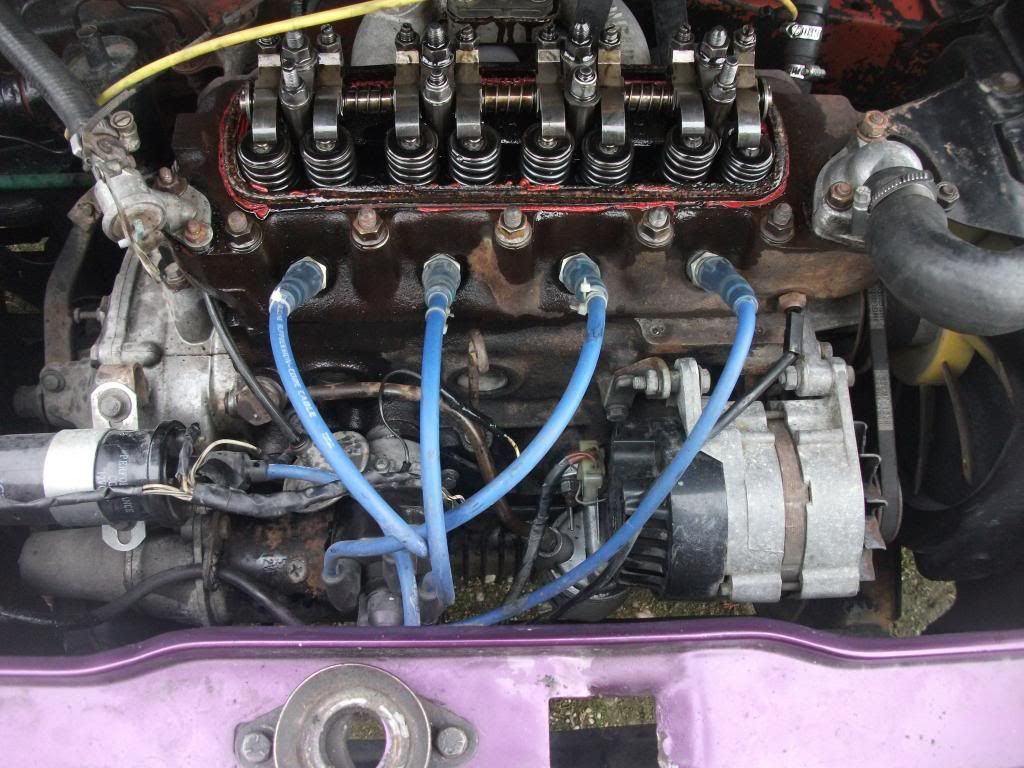

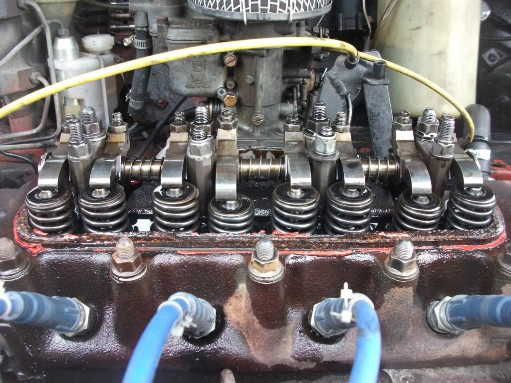

here what the rockers look like
head is a 12G940 , Ive also warmed the engine the taken the cover off then as its idling put a finger on each rocker 1 by one to see if that makes a difference in sound = nope!
engine has been rebuilt at some point Estimated 30,000ks ago
any other ideas lads?

For my own education...Should the rockers be centered over the valve stems?

Might be the pic but some off the rockers look close to the washers
