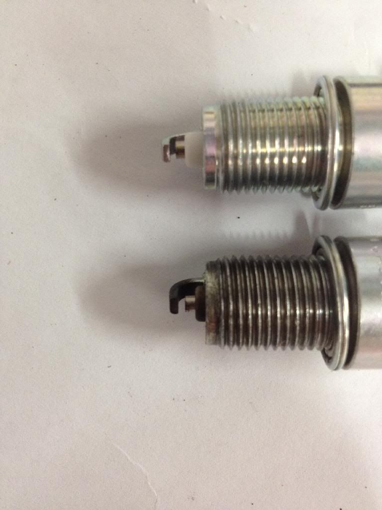

For future reference here is the length difference between a BP6ES on the right versus a BP5EY on the left. As the Doc pointed out, the length of the electrode/snout is a tad longer.

Happy to stand corrected but from my recollection of plugs and heat ranges, the longer the centre electrode the cooler the plug heat range.
the plug is cooled by the incoming charge, so the more it protrudes the more cooling it will recieve.

Nope sorry, it doesn't work that way- the longer the insulator, the longer the heat path to the body is, = it runs hotter.
Shorter insulator = runs cooler but more likely to foul.
