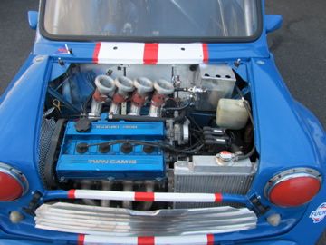

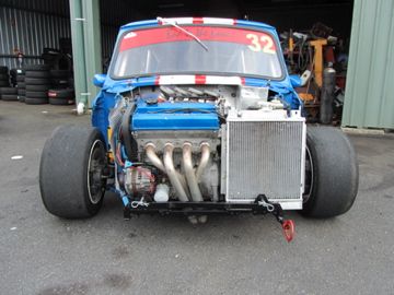

I have one in my track mini that you are welcome to have a look at, but it's obviously not road registered.
There is plenty of info on the pros/cons in the Engine Conversions section of this forum.

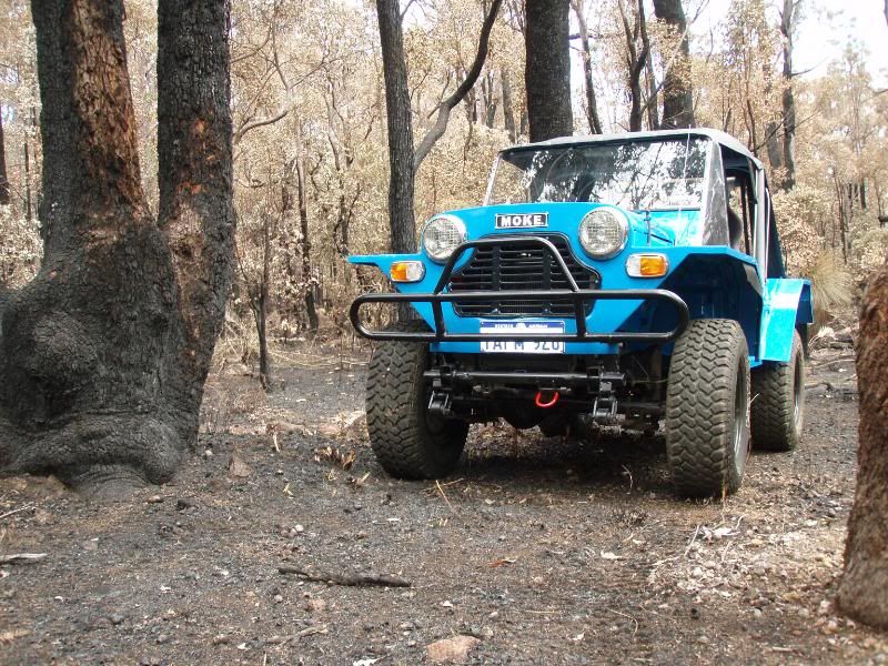

Wow nice mini. I noticed your name. Any links or anything to the build of this AWD Moke? It's one of my dads life-long plans to build one. He always wanted to take the running gear of a Suzuki Sierra-engine, drivetrain, suspension components, the lot. He still wants to but he needs encouragement...

How's this for encouragment?
Mr Moke's MinZuki:
http://www.ausmini.com/forums/viewtopic.php?f=2&t=80847
Doesn't look that big in real life, especially with him in it!
As for my moke, there are some details in the Conversions Register:
http://www.ausmini.com/forums/viewtopic.php?f=23&t=19482
Unfortunately I lost the build log on the site that was hosting it.
Good news is that I got the moke back two weeks ago, so time to do some more work on it.

Hey awdmoke. That race car is nuts. Nice work.

I can't take credit for building it.
It's developed over the years in the hands of a couple of more experienced racers than me.
