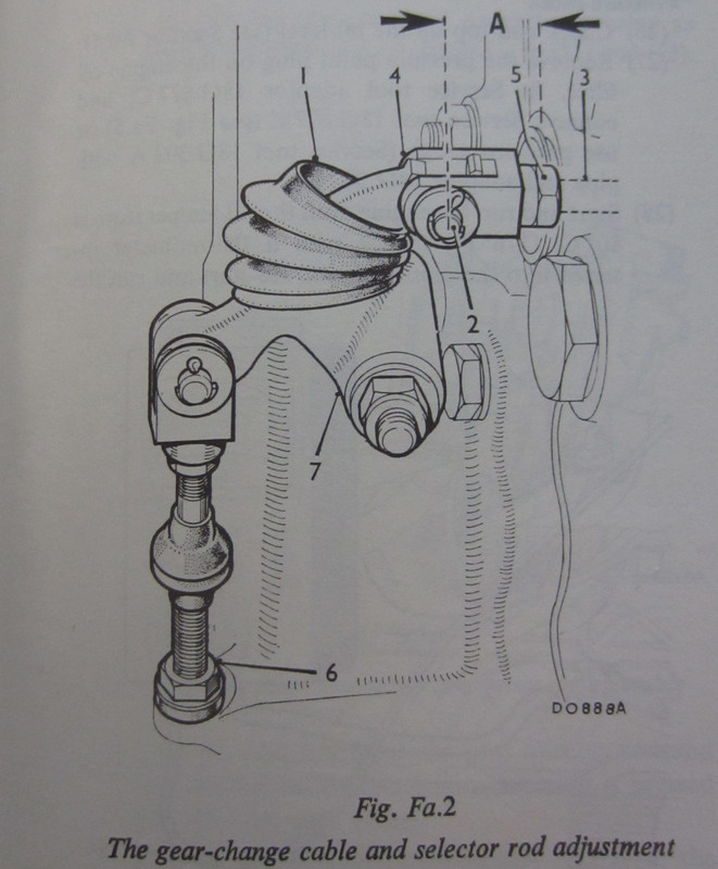

The next step is to drop the motor in the car and test out the auto under load. I'm missing a part that joins the selector cable to the gearbox and have had trouble finding a photo of it online or in my books.
If I can't find one I am sure we can fabricate something similar, so would love some images of what I'm missing.

From the Australian Morris 1100 workshop manual.

Thank you for the pictures they will be helpful. Where in Melbourne are you 68AUTO ? It would be good to see one in person and take some measurements.
Thanks again.
