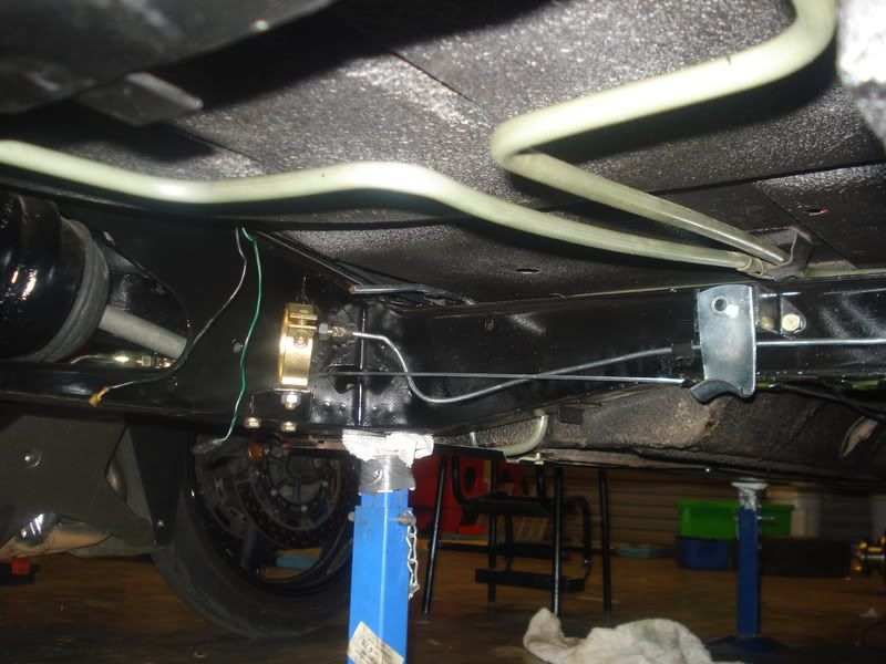

I wish I could help more, but here is the underside of mine. The hydro pipe swings straight inboard, so I'm fairly certain the breather will not have a problem going to the outside, but my memory is a little vague on what goes on behind the subframe...

It seems that the Mk 1 & Mk 2 hydro lines are different, as yours with the full length pipe covers are about ten inches further outboard than mine, (which have corner covers only), & are located close to the exhaust pipe tunnel.
From your picture, the breather pipe would definitely be on the outside of the hydro line, so that's where mine will be going too.

It isn't a Mk1/Mk2 thing, it was changed some time in 67, so about half way through the Mk1.
