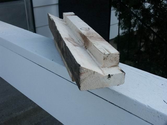

You can jack on the front cross member but you should use a "special" shaped piece of timber and their are details on this timber in some Factory manuals and handbooks.

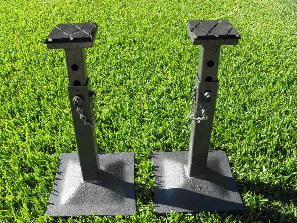

You need one of these

Don't tell me your lawn actually looks like that....
