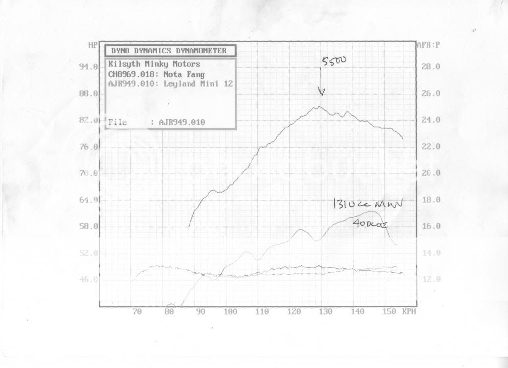

lightly ported inlets and exhausts, 1 mm bigger vales, 176 cam { large and lumpy } 1556 cc, light flywheel / backing plate. Done on a chassis dyno in Kilsyth.
PostPosted: Fri Jan 03, 2014 1:32 pm
Posts: 883
Location: Airport West
i forgot to add 14.5 to 1 comp + good fuel

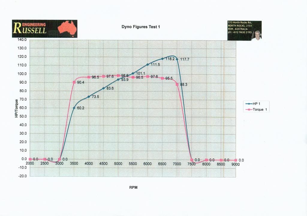

PostPosted: Fri Jan 03, 2014 3:43 pm
Posts: 39757
Resize of 1412 + HS6 by k_green1310, on Flickr
1412cc stroker, RE13 cam, 1.46:1 Corolla rockers, single HS6 carby on RE7 manifold, Maniflow med bore LCB. 12G1316 (LS) head, ported with Mk2 S valves. C/R 10.5:1. Fuel BP98 Ultimate.
Note with a 45 Dellorto on instead, and 38mm chokes in, torque was only 107ft/lb, and HP was 114. But yes it sounded tuffer. :P
[edit] miniDave's 1330 rally motor made about 97ft/lb last year on the same engine dyno, it has RE13 cam, 1.5:1 `forged' MSC rockers, near stock Mk2S head (GR profiled seats) and twin HS4s.
