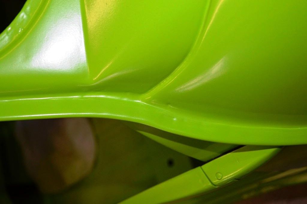

I just finished this job and I ended up sticking my seam covers on with Sikaflex auto adhesive and no metal clips.
This is the first time I've done this so I don't know if it's long lasting or whether it will remain crack free.
I also wasn't concerned about the "originality" of the appearance of the seam/body join as the van is a daily driver and I just wanted a good waterproof seal.
I just filled the seam covers up with Sikaflex, pushed them on and smoothed/removed the excess with paint thinner.
I then taped them up overnight until it all cured and overcoated with high build primer and then the main colour (acrylic lacquer).
Here's how they came up;
Dave
Dave
Thanks for the photos mate, thats great.

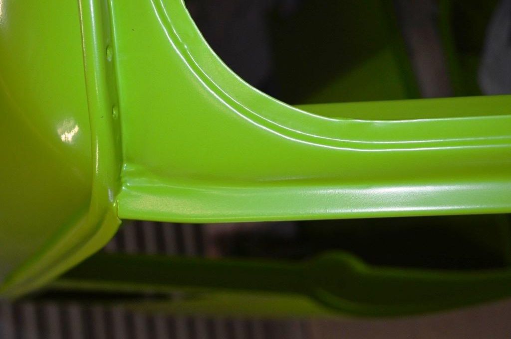

As above, Sikaflex is so much stronger and easier. I've done two Mini's this way. I've used SikaFlex on Cars, Buses. Trams and Trains. It's great stuff!
The only issue is that the seam moulding is stuck for life. To remove it, requires grinding down the fold of the moulding, then peeling it off as two bits. However, mouldings are cheap, and if you do it right from start, they can stay on for near eternity.
My process:
Clean the seam back to clean raw metal.
Couple coats of primer
Fill new seam moulding with Sikaflex
Clamp onto seam. (G clamps, lengths of wood, etc etc)
Gently wipe excess away. Avoid using solvents (at this stage)
Leave overnight.
Next day (or at least (say) 8-10 hrs later, remove clamps and any wedges of wood etc.
The overfill (Ooozz) can simply be scrapped off using your finger nails (no good for nail chewers!)
You should be able to get all visable Sikaflex off, right up to the join.
You can now sand (240grit) lightly, than apply another light coat of primer.
Nothing looks worse than tracks of sealer down each side. All sealers flex and shrink and crack the paint and allow for rust. The above method makes it totally waterproof.
One of mine:
Goodluck.
Alex.
