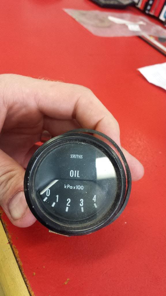

Ok, I have an oil pressure gauge question so ill tack it on here.
Would this electric gauge have the right pressure range to suit a mini?
I found it at work today.
I currently have a pricol mechanical one, but I broke the line, so im considering swapping to this electric one if it would suit. And if I could find a sender inexpensively.
