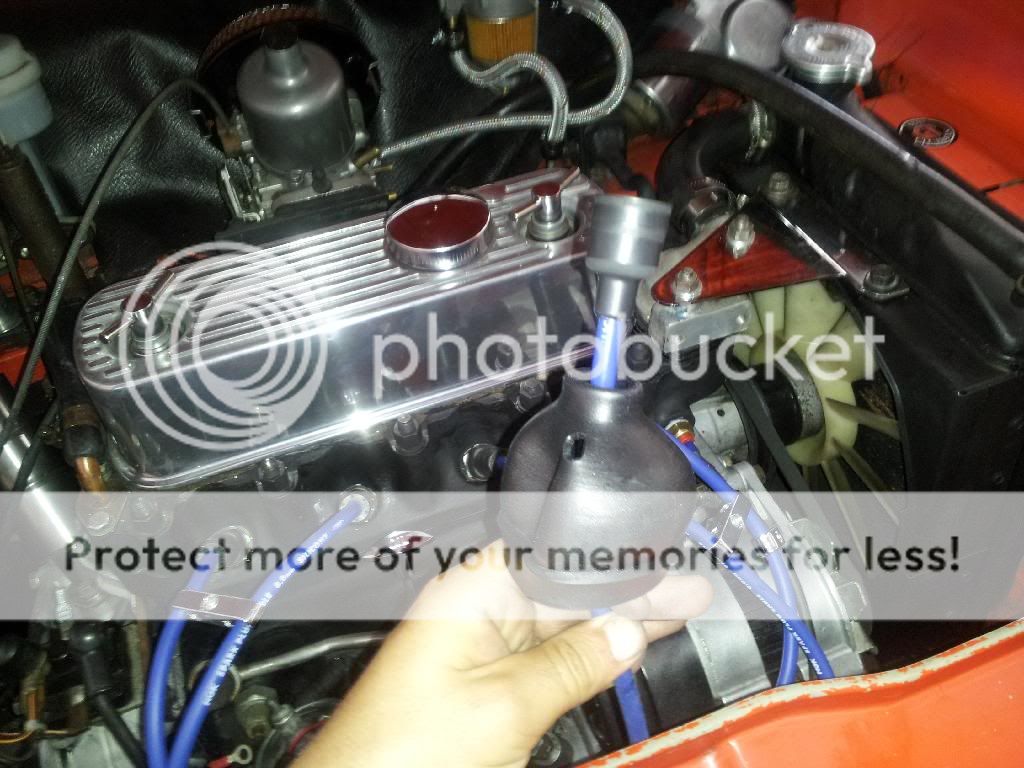

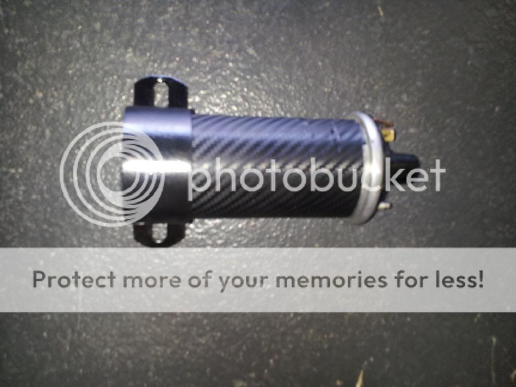

new wiring to coil
tuned the carby with Gunson Colortune (best tool so easy)
top up car with bio race fuel left over
wow car is ruuning really good now
