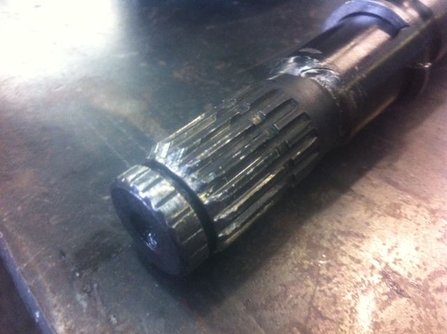

...Well, I think I went a little too fast over that table-top speed bump down the street from work, and the outer CV ring couldn't hold. I know the outer spline doesn't do anything once its all together, but its machined itself off as i coasted to my work. I'm buying a new CV outer assembly, do I need to replace the shaft?

Replace the shaft, and put a new circlip in.
Re-using this will cause more of the same problem.

Which side are we talking? I may have a spare. I ordered one last year for the same reason, and received the wrong side :roll: It was my bad however...
I did find however that the detent ring didn't really have any tension in it allowing the shaft to remove itself. I ended up forming one myself from spring steel (piano) wire.

Its the right side (longer shaft)... Thanks Harley, thats what I suspected :oops:
