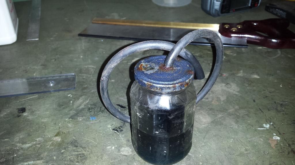

PostPosted: Tue Feb 11, 2014 7:41 pm
This is my Shaky Industries One Man Bleederâ„¢ :P Its survived 13 years with much the same brake fluid in it :lol:
I wouldn't mind putting together a decent one like above however...
I might give it a go.
PostPosted: Tue Feb 11, 2014 8:05 pm
Posts: 1479
Location: Qld, Brisbane
You could at least use a clear piece of hose Mick! My bleeder must be a different brand though because it's made from and old plastic laundry liquid bottle.
PostPosted: Tue Feb 11, 2014 9:21 pm
mini_mad_matt wrote:
You could at least use a clear piece of hose Mick! .
Perhaps it was once... :P
