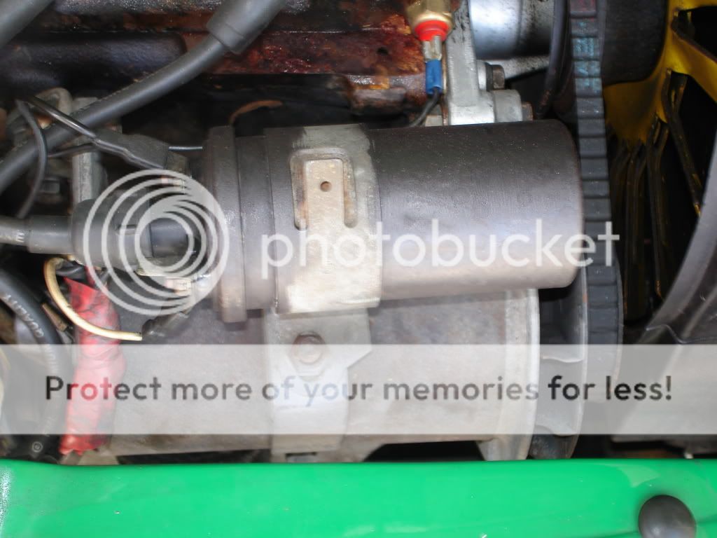

My ignition light has been constantly on while driving and the battery finally run out of charge, I assume that the alternator has gone, but while looking at the parts I’m not sure if it is and Alternator or Generator?
Which one do I need?

Could be a voltage reg problem.

That is a generator
Now is the perfect time to think about upgrading to an alternator!

That's a generator , your battery will most likely be wired in with positive earth (unless the voltage regulator has had it's polarity changed ) so will need some modifications if you intend to fit an alternator . Personal preference and the amount of accesories will decide what you do , big stereo would be better with an alternator but I like generators in my mini's for looks and simplicity .

That, as above is a Generator. You may just need to get it reconditioned.
Is your car neg- or pos+ earth?

How can i tell if its Neg- or +pos earth?
PostPosted: Thu Apr 02, 2009 1:34 pm
Look at the battery , which terminal (will be marked with a + or - on the battery) goes to the short cable attached to the body and which one goes to the long cable that runs through the floor and up to the engine bay ?

Its Neg - Earth, will an alternator bolt straight in? Or best to stay with the generator?
PostPosted: Thu Apr 02, 2009 2:18 pm
Posts: 39757
Alternator will bolt in if you change the rear bracket.
You will need to do some rewiring around the old voltage regulator area.
A modern alternator has a regulator inbuilt.
Nothing wrong with generators though, usually it's just worn brushes, or dirty points in the regulator.
