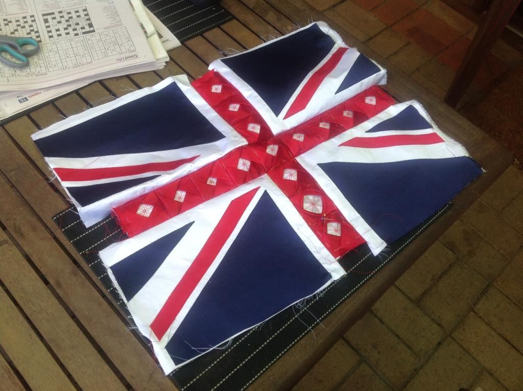

My Daughter is doing a HSC textiles protect which will be a mini made of fabric. We are hoping to create of carve the shape of a classic mini in foam which will act as the structure under the fabric.
She could carve the mini out of a large block of foam or perhaps Cad Cam would be an option (although I imagine an expensive one.)
Can anyone suggest where in Sydney we can buy large blocks of foam. The mini will be about 90cm long so we need a big block, or glue smaller blocks.
Below is the roof which is a union jack. I might even start a build thread!!
